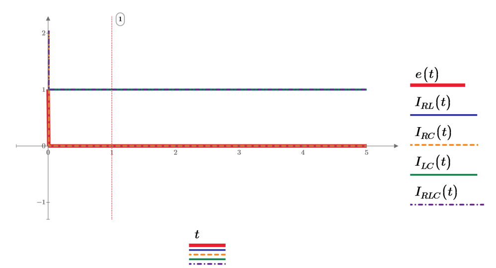

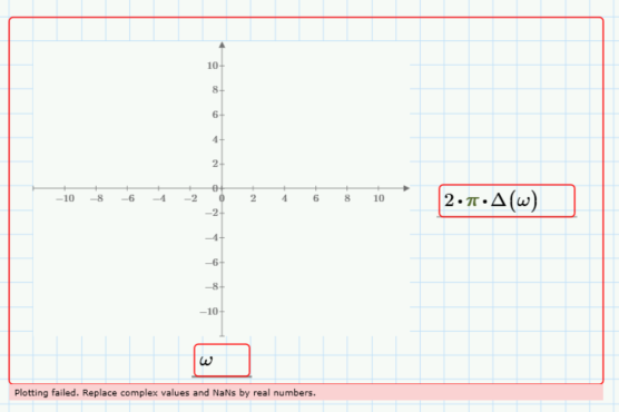

Plotting failed for Dirac Delta (Unit Impulse) Function. Why?
Cornel

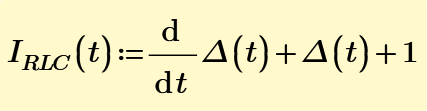

Do I need to define the dirac delta (unit impulse) function separately to be able to use (plot) it?
Mathcad Prime 8 file attached.

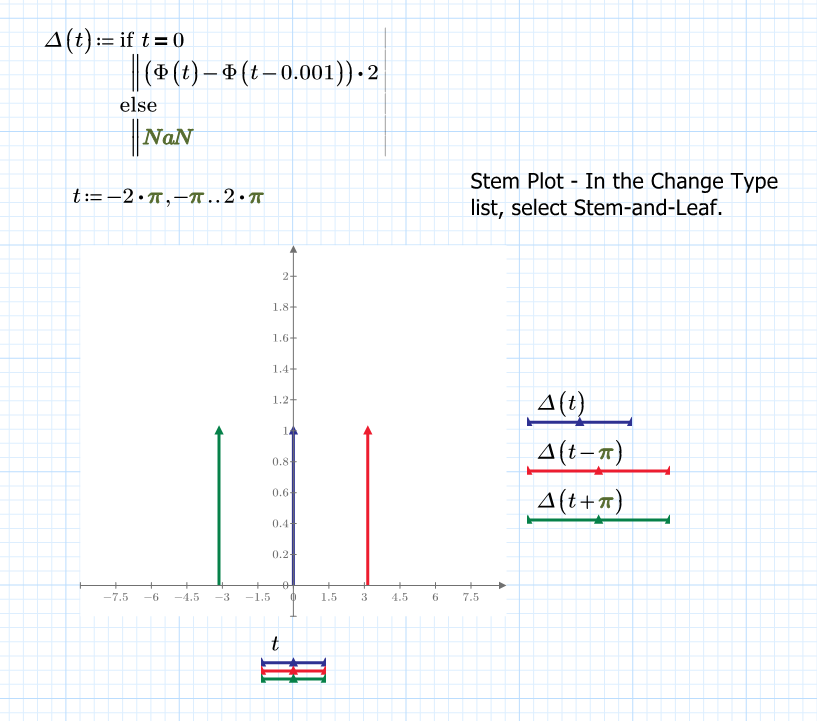

ttokoro
(To:Cornel)
Change plot type as below.

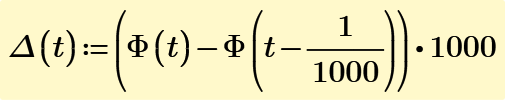

The Dirac impulse has infinite amplitude and infinitesimal width. You can never make a graph of it. You can make some approximations, for example with a rectangular impulse of amplitude 1/ε and width ε so that the area of the impulse is always unitary.  with ε small as desired.
Cornel
(To:-MFra-)
Which is more correct to use between delta1 and delta2 function implementations?

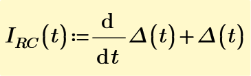

Cornel
(To:Cornel)
But then...I do not know if I will can evaluate numerically further with this functions defined above.
Which should have the value of 1, right?

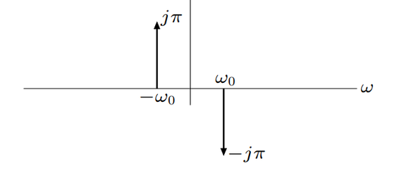

Cornel
(To:Cornel)
Let's say that I want to plot the fourier transform for cos and sin:
So, this graph:
And this graph:
How can I plot these 2 above graphs in Mathcad Prime 8?
-MFra-
(To:Cornel)
The pulses have infinite amplitude and area p, therefore the infinity symbol is placed on the arrow and the area on one side. For example, see figure. this applies to any Dirac impulse (positive or negative).
Sometimes the Dirac impulse is confused with the unitary impulse which instead is an impulse of amplitude one. It is represented with a dot, and often with a bar that connects it to the abscissa axis and is used in the theory of digital signal processing (see, for example, the attached file).
ttokoro
(To:Cornel)

ttokoro
(To:Cornel)
As MFra already say, it is impossible to plot delta(t).
The only we can do is to make delta(t) as already you make above.
I also do same technique to plot the impulse image om the 2D plot.
