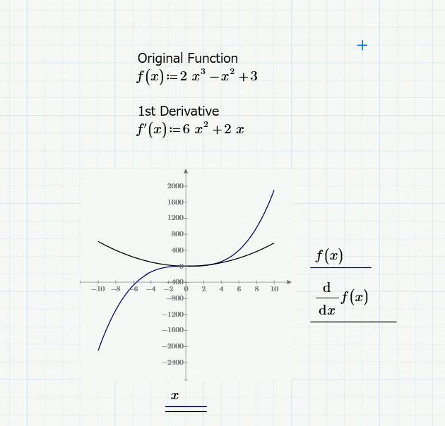

Hello, I am working on an assignment that asks me to "plot the function (y(x)) and the first derivative of the function." Now my function is (2x^3-x^2+3) and its first derivative (6x^2-2x). For some reason, I cannot get the plot to show up like I know it should, It just doesn't look right. How would you all go about plotting this? (PTC Mathcad Prime)

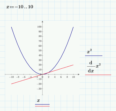

I guess that you are confused because of Primes autoscaling. When using a so called quick plot (the variable x used at the abscissa must not be defined), Prime choses the values for the x-axis to run from -10 to +10. So the y-values are rather large and Prime has to scale the y-axis accordingly (look at the scale values in your plot) and this results in a heavily vertically squeezed plot.
There are two ways you can control this.
The first is to edit the values at each axis. You can edit the first, second and the last value at each axis (highlighted in yellow in the picture below). This is not a particularly intelligent solution, because hitting the right spots here can be very challenging, but once you do it works.
As you can also see in the picture it is not necessary to define the expression for the derivative. Prime will use a numerical algorithm to make up the plot. At the bottom of the picture you can see that you can also use the symbolic evaluation to show you the exact expression for the derivative.

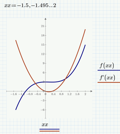

A second way to take over control of a plot is to define a range variable for the abscissa values. In the following picture I just used the name "xx" to use something different as in the picture before. Of course you can also use simply "x" as the name of the range. Note that Prime still will automatically adopt the necessary range for the y-values and the autoscale it selects is not always very clever, But you still can manually edit the values as explained before.

Here is what I am working with. I'm in Mathcad Prime 5.0.0.0 academic.

I think the reason I was so confused was the range in which the graph was plotted. My graphing calculator, while looking similar, was scaled way down, so I think my problem was the scale. Thanks everyone for the help!
