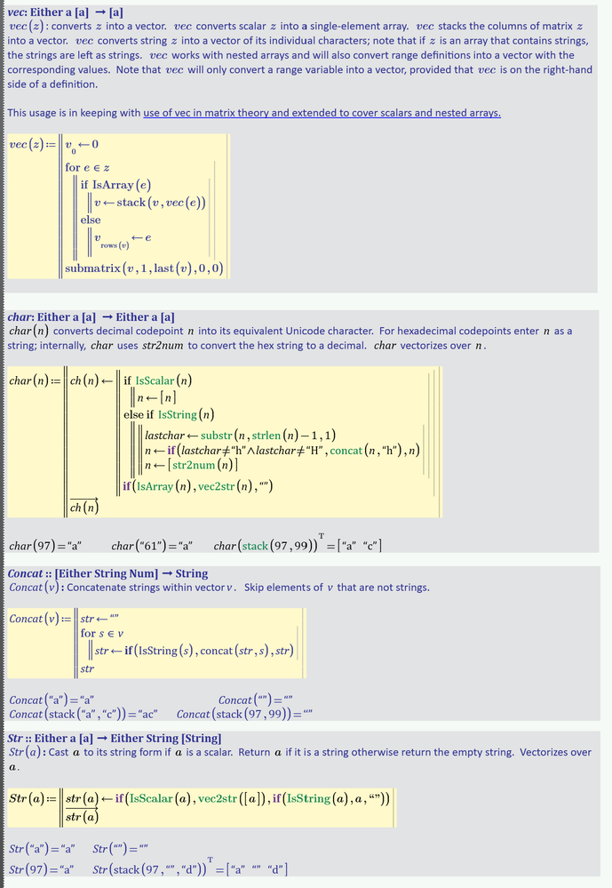

Here are the functions I use.
Plus the updated 'dot' functions and alphabet strings.
Stuart
Revised version of worksheet uploaded.  This new version includes some of my, slightly modified, set of string functions.

Forgot to add ...
The extra string functions are only there to help generate the character table at the end of the worksheet, which was directly copied from my original 'Unicode' worksheet.  Not all of the string functions are necessary and most are overkill for what they do.  However, they had other uses within the original parent worksheet.  It wasn't worth the hassle of cutting the useful functions from the herd and taming them.
