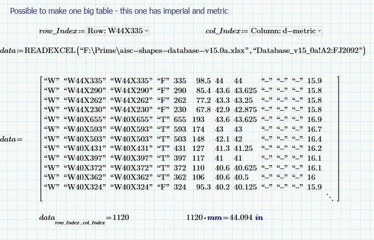

Upload the spreadsheet of the section parameters and I will show you.
Is possible to have one big table.  Simply stack the data from each section type.
Enclosed is a spreadsheet of all the sections so not sure if it covers all your sections.
