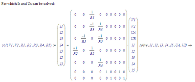

I am looking to make some symbolic equations then place them inside a matrix and solve current node mesh for the answer to circuit equation. I am looking for advice on how to do this or the advice that such an endeavor is impractical. My next goal is to find a PTC defined function to extract the coeffecient for the equations for Voltage and the unknown currents (I.1 I.2 I.3 I.4 I.5). So right as now i am looking to sort the result and THEN Store the results.

I am looking to organize the  equation (E.1, E.2, E.3, E.4, E.5).. I have five unknowns (I.1, I.2, I.3, I.4, I.5)  and the five equations already mentioned (E.1, E.2, E.3, E.4, E.5).  I want to organize the equation  in terms of  some number = an equation defined but the unknowns. I.E. (19=28*I.1+70*I.2+99*I.3-7453*I.4-972364*I.5) I then want to extract the coefficients. The place the coefficient into a matrix one equations at time till i have square matrix i can solve for. (I.E. invert roe escholon etc. etc low lever linear algebra.. if the matrix is not invertible i can throw and error?) I understand what your doing buy looking at the equations and just copying the equations into a matrix then solving for it. I am petty. i might want to do a simulation of passive components then run a script and some mathcad commands to check my other math cad work. I was working for a trainer and maybe went over board looking to use symbolics.

Hmmm, how about:
Check:
What i want to do is to take a set of equations and assemble a matrix. I am looking take a system of equations and turn them formally into a matrix. kindle.. I know i am naive. sorry so the function is maybe (coeffs, why_because_like_you)... Where coeffs is mathcad defined symbolic function to pull out the coeffs out of symbolic equation and the variable why_because_like_you is an vector of various variable names each with degree 1 (so no ^0). I am going to try that then insert the coefficients vectors one at a time into a matrix till i hopefully get a square matrix. Thank you for being patient. i will see if i can describe or come up with the answer i was.. looking for..

I shall like to see that work, but knowing Mathcad, I have my doubts.
In the mean time, here is a more compact setup:
Attached a mathcad 11 file. Autocalculation is OFF, press F9 for results.

Some remarks:
The keyword "Given" to start a solve block must be written in a math region, not a text region
A solve block can also be evaluated symbolically.
See if the attached file helps
