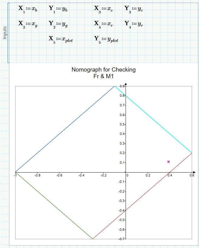

Please guide to prepare the plot as per the attached files
Enclosed is Prime worksheet that does the plot:
Cheers
Terry
Cheers
Terry

Have included a postscript so the workings are shown. The actual plot bit is easy.
Cheers
Terry

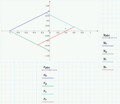

Would this do?
Prime 3.1 file attached.

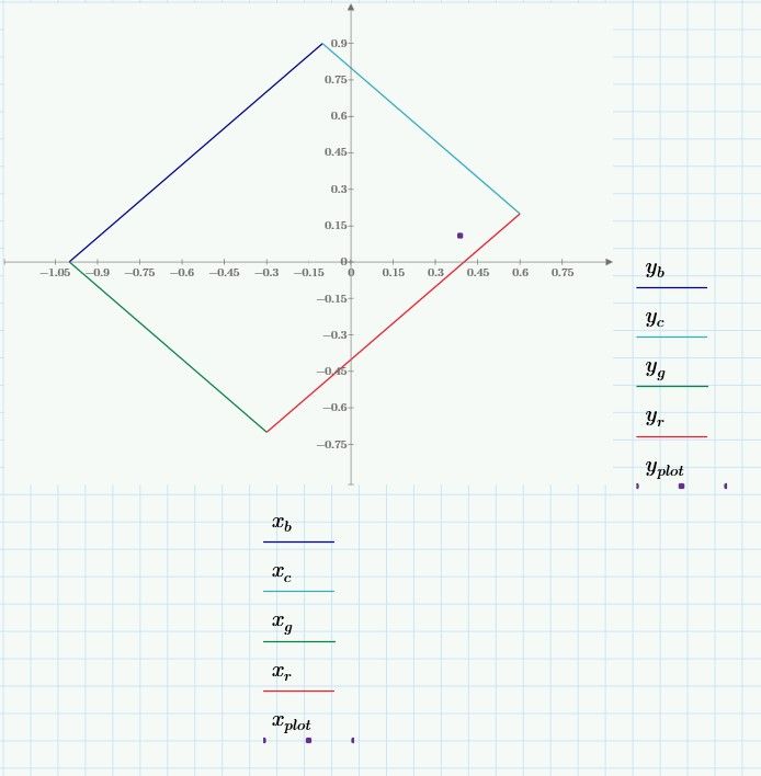

The prime 6 file alos i had added in prime 3.1. and it is working the same graph in prime 6
Thanks a lot to all

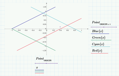

Or better like this:
