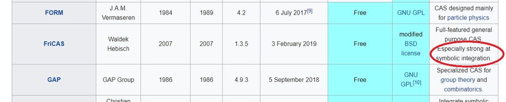

So what WIKI says about FriCAS is not true ....
(https://en.wikipedia.org/wiki/List_of_computer_algebra_systems)

(To:-MFra-)
We don't know if the problem here is FriCAS itself or if its the way its migrated in Prime. I neverused FriCAS and have no installation of it running here, so I can't verify. As far as I am aware FriCAS is best used with a Linux derivate as OS. The windows ports seem to be rather old.
And when Wiki says that FriCAS is "strong at symbolic integration", it should state in comparison with which other programs. muPad never was famous for being aspecially strong at integrals. I remember that MC14 had a lot of severe bugs in that respect and not all of them were fixed with MC15.
While FriCAS in Prime so far could not convince and is a bit disappointing, I guess that there are some integrals which muPad handled wrong and FriCAS calculates correct.
