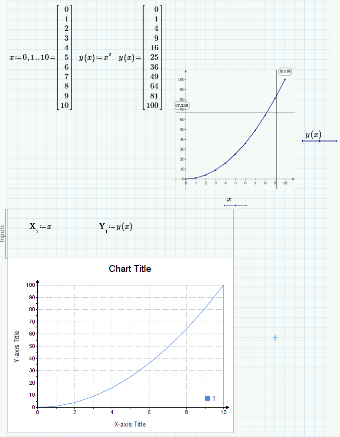

I am aware of the 'klugy' workaround (my impression and the lack of efficiency/speed) using the Math...Insert Chart Component tool/button, but for a simple, quick few clicks the 27 years of using MathCAD got rid of the basic plot tool's ability to create and customize simple gridlines. It also appears to have removed the TraceXY feature, where you can actively move the cursor, point by point along the curve to see the X, Y values at each point.
As it stands in v7.0, the vertical and horizontal 'markers' are independent of the curve or data points, making it unusable for the old TraceXY tool since it will contain random error in both X and Y values.

AS you know, the Chart Component is PTC's suggested tool to use for presentation-worthy and feature-rich plots in PTC Mathcad Prime. We're aware of and always happy to hear customer feedback on how we can improve Mathcad; but in our list of priorities to put in the next release, updates to plots weren't in Prime 8 and won't be in Mathcad Prime 9. We're still prioritising closing the feature gaps we have with Mathcad 15, so merging the functionalities of native plots and the Chart Component into one feature instead of two isn't as high on the list (but is still certainly on the list), as we are prioritising adding functionality that isn't yet possible to do in any form in Mathcad Prime.

I consider the Chart Component a band-aid, but it is overly complicated, it's hard to believe that was more simple than incorporating what has been a standard tool in MathCAD versions over the past 20+ years.

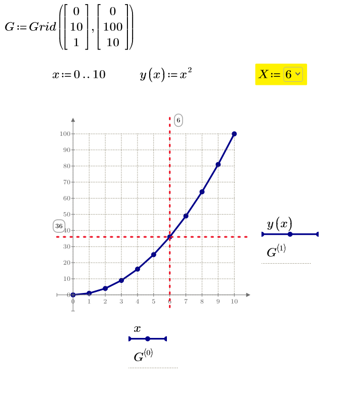

We can do Prime 8 is only this plot with trace XY.
Thanks, @ttokoro , I do not have access to Prime 8.0 yet, good to know that it is available whenever we update it. Unfortunately, until then, I guess I will have to export the data to Excel, OriginPro or other software to finish the job for Prime 7.0.
What ttokoro showed is NOT a Prime 8 feature. Its a workaround using user defined functions. The gridlines were realized by a set of line segements which are created by a function and have to be plotted as a separate trace (in ttkoro the variable G).
These user function work already in very old Prime versions, too.
I had posted that kind of functions here in the forum in the past and LucMeekes also posted his versions (the one used by ttokoro) which had the advantage of also working in the Express version of Prime.
