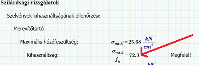

I don't know why, but mathcad prime 8 don't open the attached file. "The file type is not supported. ..." If someone could help restore the file, I'd greatly appreciate it.

Yes ofc, the worksheet was created in hungarian language.
Two matchad worksheet were open, and i closed the all mathcad. Then i didn't open this file, but i can open the other.

The file contains an (apparently) illegal 'apply' structure.
See if the attached file helps.
Thank you very much my maaan!!!😎
You save my thesis!!!😍
LucMeekes
(To:BS_11071583)
The correction I made involves this result (on page 15):
AND subsequent results of similar expressions.
You may want to have a look at what was changed.
Good luck with your thesis.
Ohh so the percentage sign was the problem. I tried to use it as a unit of measurement, but I will avoid it in the future. Thanks your help again. Have a good night!

Hi Bence,
I've tried to recreate the problem, no luck so far.
The 'legal' way for a relative/unitless result in percents is to use:
on the calculation result. It doesn't produce the illegal 'apply' construct that you managed to create.
How did you get the percent sign to be used 'as a unit of measurement' in those expressions?
Okey thanks, i just put the percent sign after the calculation result, and it worked for a while😅
