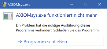

When using symbolic evaluation in Prime 9, from time to time one of two different errors pop up sporadically.
Either a window indicating that AXIOMsys.exe isn't working anymore, or a window indicating that "bad_module_info" is not working anymore.
Nonetheless symbolic evaluations in Prime still work OK, its just annoying and irritating to have to click away those windows from time to time.
Often the same error also pops up immediately after closing Prime.
I am aware that its not a Prime error but stems from Windows - nonetheless is only occurs when using Prime 9.
Anybody has experienced something similar or has an idea what the cause may be?

So, I thought it was only happening on some of our machines.  However, you only have to open Prime 9, do something simple with the symbolic solver (AXIOM), and then shut down Prime 9.   If you don't touch the symbolic engine, Prime 9 shuts down just fine - no error.  Apparently AXIOM doesn't start up unless you try to use it.

  2. Solve  a*x² + b*x + c  symbolically for x.
  3. Close Prime and see if you get an error message pop-up from Windows that Axiom has stopped working.

For completeness sake, here is the window I get after closing Prime.
Its in German and says something like
AXIOMsys.exe has stopped working
A problem prevented this program from
running correctly. Close the program.
-> Close program
While this window is displayed, the task manager  shows that both processes, AXIOMsys.exe and also MathcadPrime.exe are still running in the background even though the Prime Window is already closed. Only after getting rid of the error message (either way) both processes disappear.
