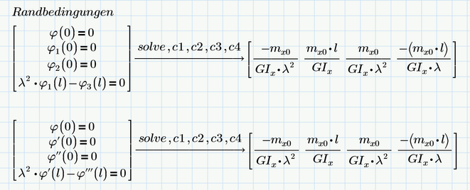

Hey guys,
Im new to mathcad and after searching for a while, I still didnt find the solution. I just want to solve after 4 unkowns (c1, c2, c3, c4). I have 4 equations and 4 boundary conditions, but there is a problem of the definition of my unknown variables and my functions. Can anyone help me? If yes, please correct the data I am uploading or explain to me like step by step. I am really new and just saying "you need to define correctly" wont help me. Thank you very much in advance!

I see no problem in your sheet!
The redd errors are from the numeric engine which complains because of the undefined variables c1, etc.
This does not affect the symbolic engine, though.
You could avoid these errors if you make phi and its derivatives functions of x AND of all the unknowns.
But I agree that the solution given by Prime must be wrong as we should not expect to see any "x" anymore.
The problem was rather hard to spot - it was the the exponent in x². You used the superscript "2" (on your keyboard AltGr-2) but you should have typed x^2 instead!!!
Once you correct this, you will see
BTW, there is no need to define the functions f1,2,3 - you could as well use the prime symbol ("Ableitungsstrich") for the derivations. The keyboard shortcut for a German keyboard is Ctrl-ä.
EDIT:
Arghhh!!!
Just noticed that Prime did not simplyfed lambda*lambda^2 to lambda^3.
Had overlooked that you made the same error when you typed lamda² instead of lambda^2
So the solution looks actually that way - much friendlier 😉
Corrected worksheet in version Prime 9 attached

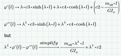

Hey Werner,
thank you very much for your response!! I really learned a lot now. But it seems, that there is still something wrong, because the solution for c3 and c1 should be somethin with a sinh function. C2 and C4 are correct!
Here are the correct solutions, what we should get from mathcad:
I think maybe we still have a definition problems? for the constants especially. There is still an error for c1, c2, c3 etc. It is very weird because as I said the solution for c2 and c4 are correct, but not cor c1 and c3. I now tried to write the derivations on my own, but still the solutions doesnt change. I would be very grateful if you could have another quick look. Thank you again for your help until now!
(To:Nexiz)
IMHO the solution given by Prime is correct.
Expression in sinh and cosh of l*lambda can only stem from the fourth equation and we simplify it, these terms cancel which means that the solution can't contain them.
I see three possible explanations:
1) The definition of the function phi(x) in your Prime sheet does not match the one in your manual calculation
2) The fourth equation used in the Prime sheet is not the same you used in your manual calculation
3) You made a mistake in your manual calculation
