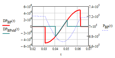

P.S.: I had rewritten your function p(t) using the Heaviside unit step
(the "if" is the reason why the symbolic fails) but now the derivative includes the Dirac Delta, which is a symbolic only function and available for numeric use like plotting.
I used a very bold (and not recommended) "fix" by setting Delta to constant 0 (and even constant 1 worked).
As you can see assigning DP.BP the result of the symbolic derivative gives the expected results
Instead of using the symbolic evaluation you may also use the optimize option you get when you right click the assignment expression.
Here a comparison of this new, correct derivative and the old (numeric) one.
So I would conclude that you ran into a crude numerical inaccuracy of the implemented numeric derivative algorithm.
I am not sure it the reason is the discontinuity of the derivative or the discrepancy between the small x and y values. I don't know how the implemented Ridder algorithm (according to the help) works.
But I am not sure how to repair the numeric derivative as it seems not to be affected by CTOL or TOL (at least lowering these two system variables had no effect concerning your plots).
Maybe a user-written function to do the derivative may help, but I am not sure how it would deal with discontinuities in the derivative. I remember that in the past ever so often user complained about the numeric derivative being to inaccurate for some special function and self-written function to do the derivation were offered (and sometimes solved the problem). Maybe you can find something useful using the search function here in the forum.

OK, at least I found a workaround for the inaccuracy problem with the derivative.
Lets stretch the curve in x and y direction by a factor "scale" before we apply the derivative and scale it back afterwards.
The missing vertical at tpulse in the left plot can be "fixed" by defining a finer range for t to be used in the plot

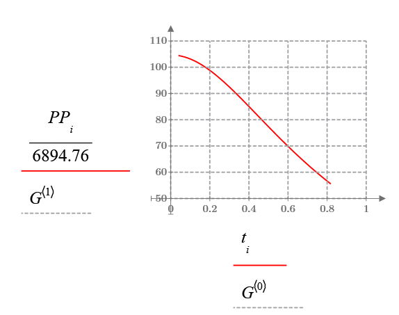

Many thanks again for your persistence. It seems I will have to construct a function for BP(t) with some smoothing functions that are more easily differentiable. The half sine transient was an attempt to generate a dummy file that is representative of my actual measured BP data (below).
 I will try some curve fitting to see if I can generate a function that looks similar to the test data.

With a noisy signal like the one you show, the numerical derivative sure is useless. If you know which kind of function type you expect, you may try a fit using genfit() or a solve block with minerr.
Otherwise smoothing sure might be an option. Be sure to also look at the functions available in the Data Analysis Extension Pack (Help->E-Books).
