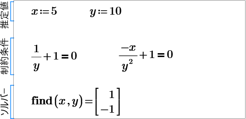

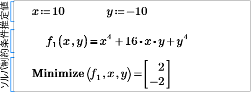

1- How do I solve a system of equations without knowing its guess values? I took me a while to get the values x=5 and y=10 otherwise the equation solver does not work.

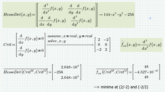

Primes infamous auto-labelling feature often is more a PITA than helpful.
You have to manually label the variables after "solve" to be "Variable" and NOT "(-)" (automatic).

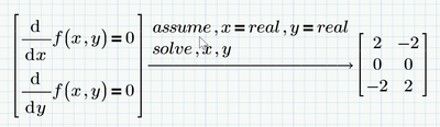

And in case you are not interested in the non-real solutions, you may add an appropriate assume modifier:
If you make f an additional argument of "HesseDet", you may use this very same function for any of your given functions without having to redefine any more.

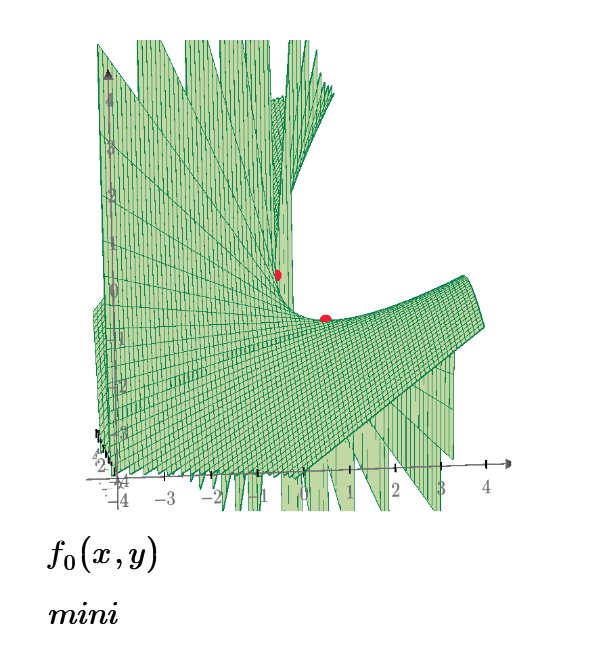

The saddle point  is [x,y,z]=[1,-1,-1]   Another point is [0,0,0], which is left above, is not saddle point,

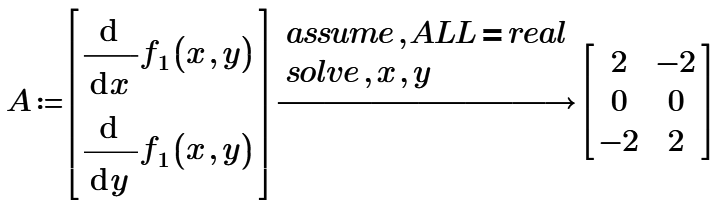

Sure there is. If at all possible you should first approach such problems symbolically.
For f0 you have all the solutions:
There is only one.

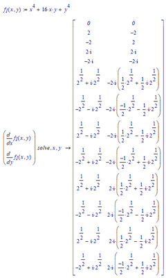

For f1 you should get something like:
if necessary add 'fully' to the solve directive.

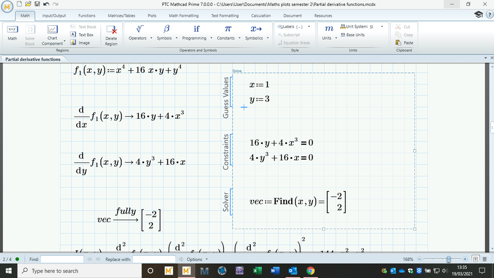

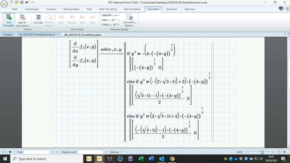

ok thanks. It seems that using 'fully' does not work when using solve block, it does work when storing the equations in a vector like you have. Screenshot (240).png
Just one more question: where do all these complex solutions come from, does it have infinite solutions?

'fully' is a keyword for the symbolic solver. Prime does not have a provision to solve  solve-blocks symbolically so you cannot use it there.
There are not infinite solutions for the f1 function because f1 does not involve periodic functions, just the 13, some of which involve complex numbers.
You should try to replicate my example for f1 in your Prime; Create a vector of two elements and put in the two derivatives of the f1 function, then symbolically solve that for x and y. (I can't do it, I don't have a license for Prime, am limited to Prime Express, and so cannot use symbolics. But I can always open and view your Prime sheets. My work is generally done in Mathcad 11, that's why it shows differently.)

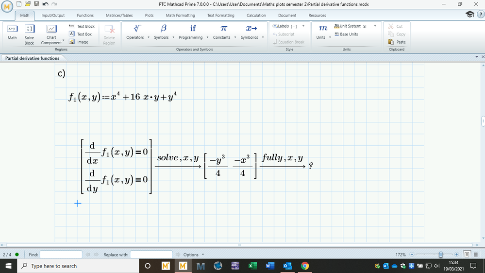

So I copied exactly what you did however it did not work, then I tried making it equal to zero but still no answer. Then I tried using 'fully' but now it doesn't work at all, it returns with a question mark. I attached my worksheet(please go to part 'c)' ignore the rest they might have mistakes from earlier.)

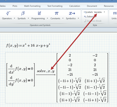

Prime has this wonderful feature of autolabelling. This serves to change m to a unit m, for metre, kg to a unit kg for kilogram. It also detects sin and recognises it as a function sin, etc.
So it will automatically assign a label to whatever you type. This is great, but everything that goes automatically CAN (and as Murphy will have it) WILL go in error (sometimes, or often). It's what happened here.
Check the labels of the x and y as arguments to function f1, and compare that to the labels of x and y that follow the solve keyword. Make them the same if different and see what happens.
Best is to have them all labelled as 'Variable'. Note that a label '(-)' means 'automatic'.
Regarding 'fully': That is not a separately usable keyword, but MUST follow 'solve' keyword. So if you need it, type it after the variables you are solving for like this:
solve,x,y,fully

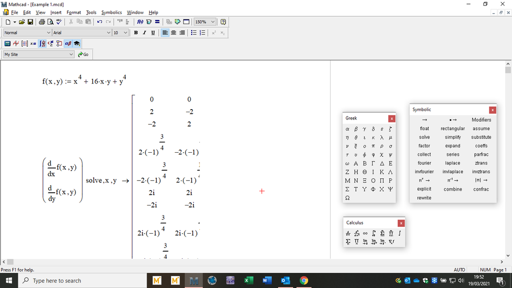

I changed the variables and started a new worksheet just in case; however I don't get the full vector of solutions like you did in mathcad 11.

I have attached it again, I NEED help with finding all the solutions which are (0,0) (-2,2) and (2,-2). How can I do this? I want to get all the solutions like you did previously that gave all solutions including complex.
I stored the equations in a vector and used fully but does not work.

It does work now finally, but it seems like it cannot be done on MP7. I had some issues in the derivative maybe that's why. I think I might just use this old mathcad. I don't like using this old version but I might just have to........for example this comes out blurred but once you click on it; it becomes clear

Yeah so I tried the prime sheet you attached and it gives a dirty else if function, I dunno what any of that even means. I think just forget it, this is not going anywhere I will use the older mathcad. Screenshot (246).png
(To:AS_9824434)
I cannot open P7 sheets but what your picture shows, again seems to be a problem with Prime's autolabelling.
See my answer above where you have to manually change the label
