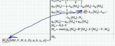

Program on page 14 is not working. Can you please help.

The only program that I can find with an error is pg 12/13, and Prime is showing that the error is because of an undefined parameter (B'):
