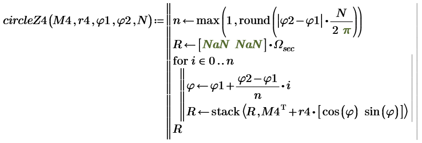

Because maybe the units of Secondary Impedance and degrees, the chunk of programming to decide if a point is inside or outside a circle fails.  See attached.
(To:Snowshoeman)
Its hard to debug a picture - especially as you don't show the variables you use when calling the function and you don't show the error message which is thrown ...
Always attach the file (stripped down to the essentials) if ever possible and not just a picture!
Best guess i that the 10^-10 must be assigned the very same unit as the other variables!
If you don't need to know if a point is (approximately) at the circumfence of the circle, you can omit that part and simple distinguish between <= (inside) and > (outside).
Thank you!  That worked.
I attached the file along with the screen shot in the first, original post.  This site must have deleted the program file.  File attached now.
Deleate NaN NaN if you add ohm unit for the other data.
I'm a new user.  How should I apply the above?

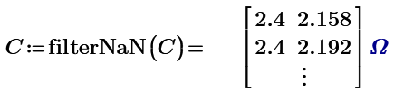

Check many points.
What you posted is pretty amazing.  I'll weed through it tomorrow.  Thank You!
So for now, the finished product is attached.  As I get more skilled, I can enhance the program.
stack needs [NaN NaN] or first row data with same cols. But if you do not need [NaN NaN], serect the data using submatrix functoin.
However, it can also do as follows.
Prime plot with each area color also here.
O.K. Thank you. I'll give that a try.
