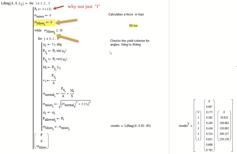

Attached is a little program that calculates the normal and shear stresses. Load P can be applied at different angles. I'd like it to report the results for the loads, angles and von Mises stress. I can't get it to run. I am also wondering if i can include the units for area, section modulus, load......

Like this?

Thank you so much!
i noticed if i change the area to 10 instead of 6 it doesn't solve.
