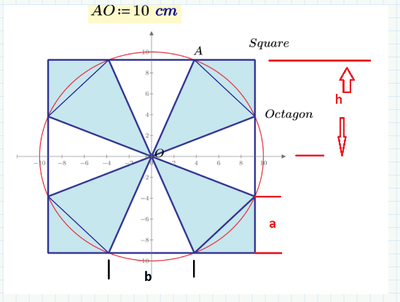

Puzzle 27 Find the blue area.
ttokoro
We have a circle with r=10 cm. Solve the blue area of Octagon and Square make the shape.
This is able to find without trigonometric function or Junior high school knowledge.

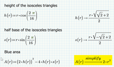

(To:ttokoro)
Too easy for Mathcad, even for Prime!
OR
3 REPLIES 3
(To:ttokoro)
OR
ttokoro
(To:Werner_E)
Without using trigonometric functions.

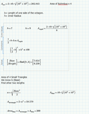

ppal
(To:ttokoro)
Using Solve Box
