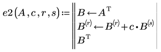

I use matchad prime 8 and for some reason this row operation doesn't work I can't seem to figure out why
(To:RR_10728663)

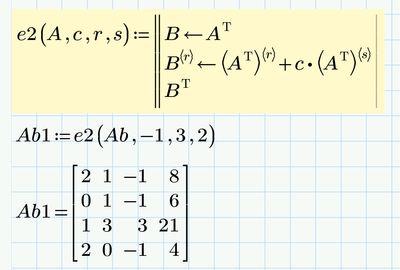

What do you expect e2(..) to be?
You never defined that function anywhere, so of course Prime does not know what to do.
Maybe you are trying to duplicate something from a source, where the author had defined a function e2( ) (obviously a function which should do some row operations on the input matrix). So you will have to look for that function definition and retype it as well in front of the failing expression.
EDIT: By chance I found it. You seem to work on the examples in the Prime help. Here the function e2( ) is defined and you have to copy the definition of that function to your worksheet so you use it. Its not a standard built-in function.
Once you copy it to your worksheet (anywhere above the first usage) you get the desired result:

Some additional remarks:
The function e2 stems from the times of real Mathcad and was taken over in Prime without much thinking.
Even in real Mathcad it could have been written a bit simpler
Prime is one step (actually quite a lot of steps) backward but there are still some rare bits which can be considered an improvement. One of them is the introduction of the row selector. Using it the function can be written straightforward
