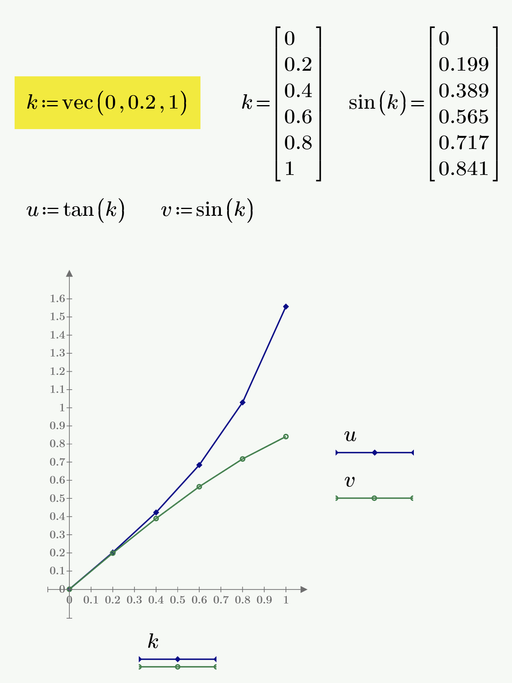

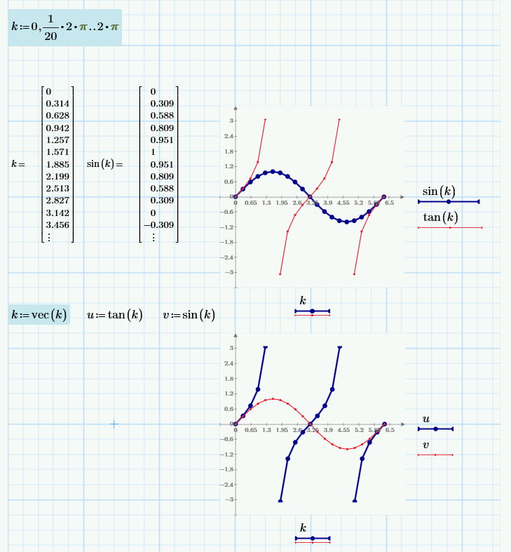

For your purpose you should define variable "k" as a vector, not a range.
Simply replace the definition   k:=0,0.2..1   by    k:=vec(0,0.2,1)   and all will work as you expected.
"vec" is a new function in Prime 11 and can be used to either define a vector (as just shown) or to convert a range into a vector. See the help for more information.
