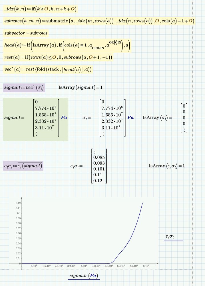

Any of the range-to-vector functions you've seen should work with what I interpret to be your problem.  Once you have converted σt to a vector, you simply apply εt to it (vectorizing as needed).
I've only got Mathcad Express, so you'll probably want to substitute a programmed version of vec for the vec` function I've used.

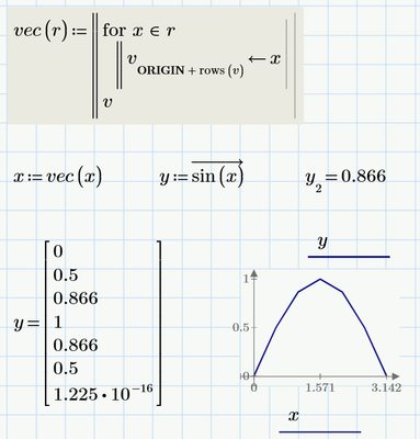

Range variables should only be used as abscissa values in 2D plots, for indexing vectors and matrices, and for loops (“for” in programs or sum or product), and for nothing else!

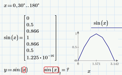

You may define a range variable x and feed it into a function like sin(x). You sure will see a collection of sine values and you can use sin(x) at the ordinate of a 2D plot.
But what you see is neither a range nor a vector. Its kind of an invalid object.
You may already have noticed that you can't even assign it a variable nor are able to access individual elements.
Solution is to define x as a vector, not as a range or convert the range x into a vector x using a function like "vec".
Now you can feed this vector x as argument in your function. You should use vectorization (the arrow over the expression) even though sometimes (like in the simple example in the pic) its not necessary. The result is a vector and it can be assigned a value or individual values can be accessed.  Of you can export these vectors to external files or use them in a plot.

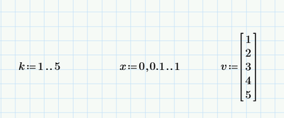

If you look at (one of) the internal representations of the ranges and vector,
you should see something like:
Simple Range Variable: k≔1…5
(:= (@LABEL VARIABLE k) (@RANGE 1 5))
Stepped Range Variable: x≔0,0.1…1
(:= (@LABEL VARIABLE x) (@STEPRANGE 0 0.1 1))
Vector:  v≔0,0.1…1
(:= (@LABEL VARIABLE v) (@MATRIX 5 1 1 2 3 4 5))
Hopefully, this might help further show the differences between a vector and a range variable as data types.

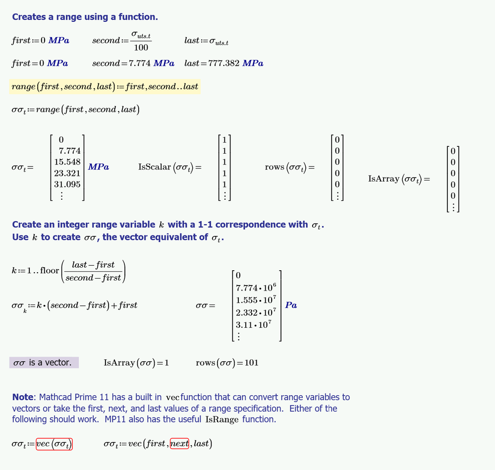

There are various other methods of skinning your particular cat.
Have you considered upgrading to Mathcad Prime 11?  I'm not aware of many (if any) downsides to doing so, and you get the built-in vec and IsRange functions (albeit, vec is incomplete as it does not flatten matrices, unlike the recommended MP10 workaround).
