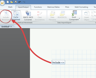

Hi there
I tried to input the results from another mathcad file , but I guess I'm doing that wrong > in the following image I'm trying to import the results of ( R)
What is the correct function to import the results from one mathcad file to another?
When I searched in the community I found very old version which doesn't open in my laptop

You may want to lookup the syntax of READFILE in the help -> Search: READFILE
Was the file written by WRITEFILE?
The second parameter in READFILE should be the type, which can be "delimited", "fixed" or "Excel", but not "Mathcad Worksheet".
etc.

I am not sure what exactly you a trying to achieve.
Is the file you try to read from a Mathcad worksheet? Then you cannot read-in variables from it using any of the READ.... functions!
You could 'include' it
This acts as if the content of the included worksheet would have been typed in at the position of the "include". So of course you also have access to the variables therein.
If you just intend to transfer a couple of variables you may be better off if you save it (maybe as an Excel file using WRITEEXCEL or by using any of the other WRITE... functions) and use the corresponding READ.... function to read in the data. But we are talking about the numerical values only, units will get lost during that process and you would have to add them yourself after reading in the data.

I guess include is the right thing to do as I'm trying to just have the values in the other sheet . However, it shows me this error , which I don't think is the case
there are no errors in the other sheet
One thing to beware of is that an included worksheet picks up any definitions made before it was included (or after if any definitions used global define).
So, a worksheet might not have any errors when run on its own, but it might if it picks up, say, a function definition that was different to its own.
  This can be difficult to track down if recursion is involved.
One thing you could try is to create an Area in worksheet "A" where want to include worksheet "B".  Then open worksheet "B", copy it in its entirety (ctrl-a), and paste it into the Area in "A".   The collapse the Area.   If there are errors, then the Area boundary should turn red.  But, at least, you'll have a starting point to look for the cause(s).

That is interesting solution , however the sheet I want to transfer the results from has 40 pages calculation. and I opened new sheet just to make it easier to read instead in adding in the original one. Maybe there is another solution to bring the results from one sheet to another ? Can you help if you know any alternative?

Hi, Yusra.
Do you still see errors when you include the worksheet in a blank worksheet?  Does your new worksheet have the same ORIGIN  as the one you want to include?
Are you sure that there are -- no -- errors, even minor ones, in the original worksheet?  I've had cases where I left an evaluation with an error.  Although the rest of the worksheet was fine, that one error flagged the whole sheet as having errors when I included it.
As for making the worksheet easier to read, do as I suggested above:  cut & paste the whole contents into an Area, then collapse the Area.  That means all of the workings will be hidden.  You could even lock the Area to prevent others having access to the Area if you're, say, sending the worksheet to a third-party.
The once caveat with Areas, though, is that a Mathcad Prime Area can't include Areas, so you'd have to partition the worksheet into several (collapsed) Areas.
Stuart.

I will do that. Thank you
