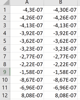

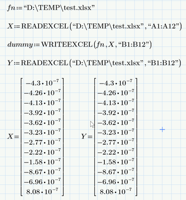

When I copy your “Before” data into an Excel file in column A, read it into Prime 11, and then write it back to column B with WRITEEXCEL, the data does not change at all. Neither in Prime nor in Excel!
Prime:
Excel:
