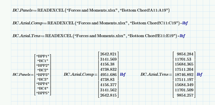

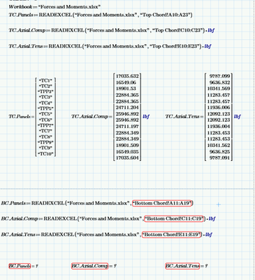

I have attached the Excel and P10 sheet. I'd like to read data from the second tab of the Excel sheet. The P10 sheet can read from the first tab of the sheet, but not the second tab. I don't know why.  Also, I am interested in reading the values in several columns. Is it better to do one column at time, or there are other options? Stuart and Werner helped me with a similar question on 8/29/20225.

Hi Sam,
I was able to read the Bottom and Top Chord data without a problem.   As a starting point, I'd check which version of "Forces and Moments.xlsx" you have installed in your Mathcad worksheet directory (your original version of the workbook didn't have the second worksheet).
As a general principle, I'd suggest reading columns separately.  You could also try putting the column numbers into a vector and then writing a program/function to read those columns.
(All I did was recalculate the Mathcad worksheet)
