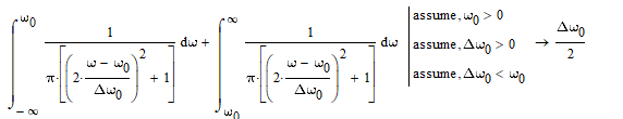

If I cannot swallow a large piece, then I cut it in half and swallow the two halves on a first come, first served basis.
8 REPLIES 8
Thanks, Valery.

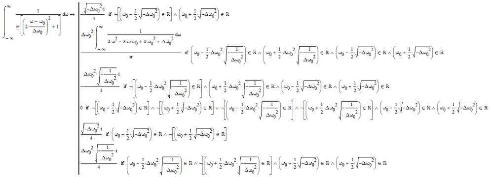

Prime with new symbol engine
AlanStevens
(To:-MFra-)

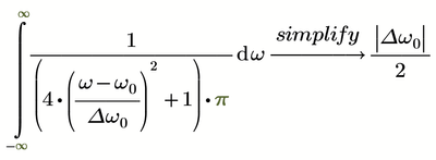

You could also do it this way:
Alan

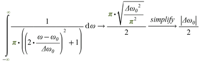

(To:-MFra-)
If I remember correctly, we have seen this kind of bug already a few times here in this forum.
Usual workaround is splitting the integral, as Valery had shown.
Here is another (clumsy) workaround (which sure is not satisfying either):
BTW, this is one of a few rare examples where the new symbolic in Prime does better:
EDIT: Had not refreshed the screen for a while and did not notice that Valery also posted the new Prime symbolic.
I like the solution Alan came up with!

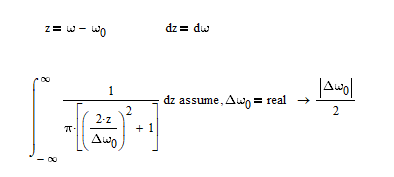

LucMeekes
(To:-MFra-)
Mathcad 11/Maple does:
