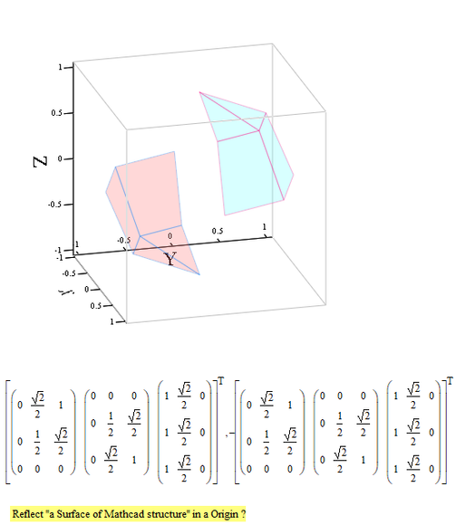

Hi, Everyone.
From the following:
Thanks in advance for your time and help.
Best Regards.
Loi.

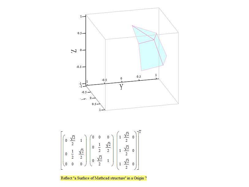

(To:lvl107)
Do you have something like this in mind?
Not sure if it a lantern, though 😉

(To:lvl107)
I am not sure if you really mean what you write!
Mirroring at the point of origin (0/0/0) means that the sign of all coordinates is changed. So a minus in front of the whole vector is enough for this.

(To:lvl107)
@lvl107 wrote:
I appreciate your time and help, Werner.🙂 Is there a any way without "by hand"
Best Regards.
Loi.
I don't understand your question.
You sure can define a function f(x):=-x and call it with the vector as its argument. But I won't consider this being simpler.

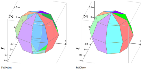

(To:lvl107)

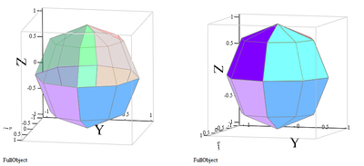

(To:Werner_E)
Or should it be something like this?
lvl107
20-Turquoise
(To:Werner_E)
Oh, Yea...h, I prefer a your "Maybe_a_lantern2.",Werner. 🤔
You gave me model of lantern as gift!. And tomorrow, I guess I had a good Idea to buy a lantern as gift to my grandchild ! 😉
(any more structure?)
Best Regards.
Loi.
(To:lvl107)
You are welcome!
Have a nice Mid-autumn Festival  (Sept. 10th this year?) and buy your grandchild the most beautiful lantern you can get your hand on 😉
BTW, the Mathcad lantern may look even better with Lighting on

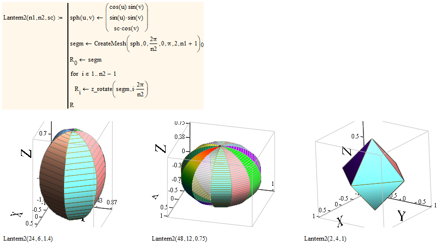

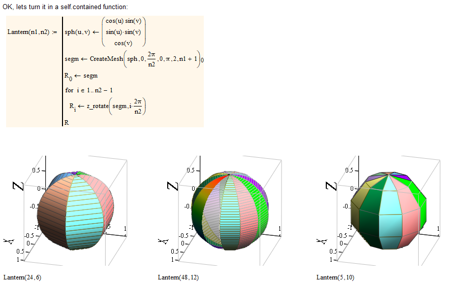

(To:lvl107)

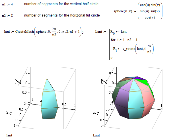

You may be interested to hear that you can let Mathcad create the necessary structure for the first lantern segment using the parameter representation of a sphere and the function CreateMesh. And, no, you cant evaluate the result symbolically, only numerically.
You may also add sort of a scaling-factor in z-direction
