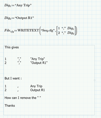

Remove "" from TEXT FILE
ppal
18-Opal
Prime 9 File attached.

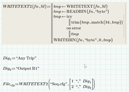

Here is a brute force workaround - a user defined function WRITETXT2() which uses WRITETXT to write the file, reads it in again via READBIN, removes all quote character (#34) and rewrites the file via WRITEBIN.
Should work well as long as the strings don't contain quote characters themselves!

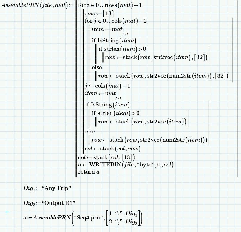

Here is a workaround that does what Mathcad 15 used to produce.  It creates a binary file which is nothing but a collection of bytes that can be read by an editor like Notepad.  It creates an extra line at the top but you can delete this in the text editor.  It generates spaces (character 32) between the items but could be adjusted to do tabs (character 9) in between if required.

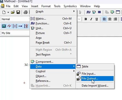

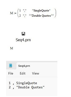

What I meant to say is a data export wizard existed in Mathcad 15 that outputted a formatted text file in PRN format from a matrix.
numbers remained numbers, single quoted text was written as text without quotes, double quoted text was written as single quoted text.
I miss this utility in Prime.
WRITEPRN in Mathcad 15 used to do exactly that but for unknown reasons they changed it for Prime?
Ah, I see. I think I never used that feature, but I sure miss data-table from that very same menu.

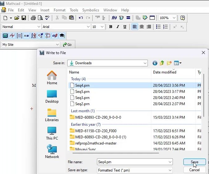

I have a two-column text file with a double apostrophe #39 (not a quotation mark) at the end of the text and before the quotation mark.  See screen shot.

So I guess you will have to resort to either Terrys AssemblePRN ( )  or my WRITETXT2 ( ).

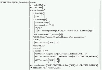

There was a sample worksheet some time ago for converting Mathcad matrices to C++ code. They ran into the same problem with the double quotes and wrote a cool function that converts the matrix strings to binary vectors (using the string to vector function, str2vec) to encode everything as binary arrays and then write the arrays to a file using WRITEBIN(), which writes binary to a file with no formatting (like adding the double quotes).
Here's the User Function (slightly modified from the original) to output the matrix to a text file with no double quotes:
Use the function as follows:
I've attached an update to your sequencer worksheet here that demonstrates this function (in Prime 9 format, since that's what you uploaded).
