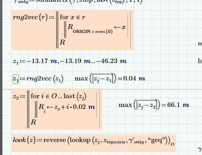

I have two vectors .. ztop and z
ztop shows the depth of each layer (cumulative value of z in each layer) . ztop  has 11 values
z shows points in that depth .. it approximately increases by 0.02 in each layer. ( it has 3670 values)
each layer has its gamma and its ztop .. ( both have 11 values)
what I need is to write a program that will repeat gamma values for each z
so I get the 3670 gamma values .
In the first layer instead of having one gamma( 17 kN/m3) one value for all the layer , I need to get a vector which repeat this gamma as many as z in this particular layer .. and do the same for the rest layers.
Can you help me with that?
No, z has only 3669 values and the increment is not approx. 0.02 but exactly 0.01 m !
Hope you have not typed in all those values manually but rather copied them from an Excel sheet 🙂
So you want to use the exact gamma value for the layer and do not want gamma to be interpolated?
So maybe this could help:
BTW, it would be much easier to create the vector z either using a range and convert it to a vector or create the vector directly using a small program.
You may also use a worksheet range variable instead of the program with the for-loop, but I would prefer the programmed variant
BTW, even though you did in previous threads, you should always state which version of Prime you are using if its not the latest. You can avoid that way to be sent a file you can't open.

What I need is to have a vector of gamma for each z point .. for example the first layer depth is 1.3 m (ztop) and this layer's gamma is 17 KN/m3.
this same layer has( let's  say )20 z points ..I need to create a program to give me 20 gamma ( writting 17 for 20 times) and then the second layer gamma is 10.1 kN/m and has 15 z points..I need to have 10.1 gamma value for each z point in the second layer.
Just breaking the ztop gamma values to z
Thats what my two functions do.

Yes, thats what my approach does.
Here you see the switch from one layer to the other:

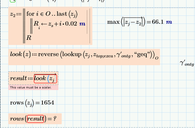

I'm doing same exercise to the one above , this time I get this error why do you think so

Can't say.
Are all elements in vector z.j scalars? Or does this vector also includes NaN's or nested vectors?
Here's another way to solve your problem.  Using local functions may help with future problems of this nature.
