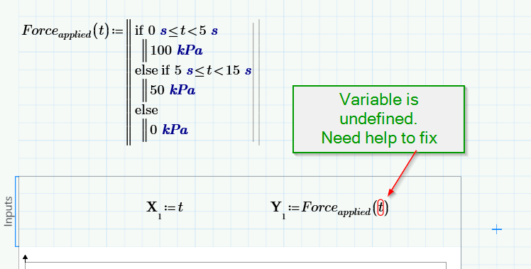

I am back to use MathCAD. Doing with MathCAD Prime 6. I am taking my own self-faced training.
I have a hard time to get this plotting done. I request someone help me.
Sample attached. Pl. help. Thanks.

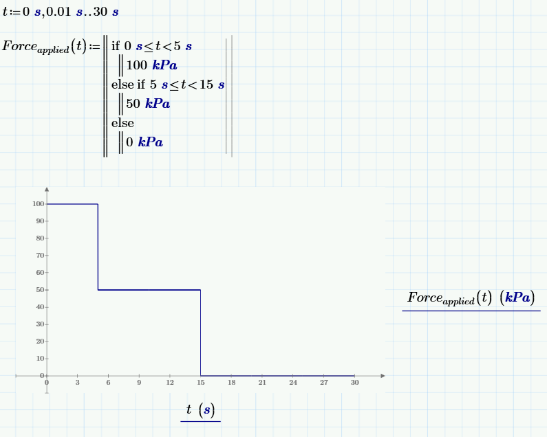

You need to define t with a range variable
t:=0s,0.1s...30s

LucMeekes
(To:RWickrama)
Try it with the proven plotting facility instead of a badly integrated third-party add-on:
See attachment.
(To:LucMeekes)
I would not call the native plotting facility in Prime to be proven, but I sure second that that third-party diagram component is very badly integrated and is more of an annoying foreign object in Prime than a valuable welcome addition.
t:=0s,0.1s...30s
RWickrama
(To:DJF)
Great help. Thanks a lot.
