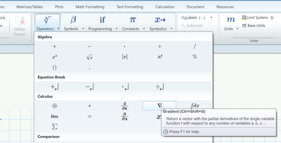

(To:Werner_E)
hey, btw can you tell me where can i find nabla operator here? I am trying to find it but am unable to do so
LucMeekes
(To:FK_10732959)
Search the online help for it...?
Or was it introduced in Prime 9 ?
(To:FK_10732959)

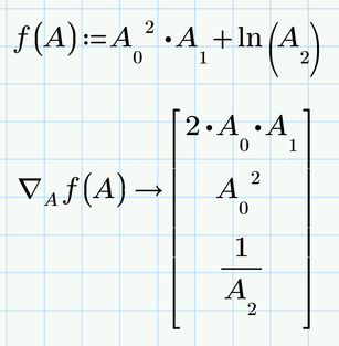

Oops, sorry! I'm afraid the Nabla (gradient) operator was only introduced with version 9 and you are using Prime 8 😞
In fact the operator was re-introduced, because in real Mathcad (version 15 and below) it has "always" existed. But Prime still has a long way to go before it is somewhat on par with good old Mathcad, if ever 😞

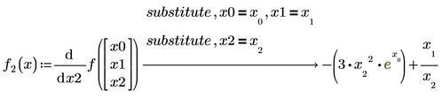

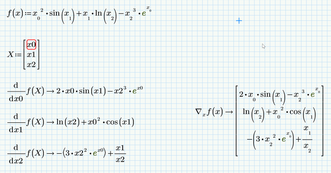

Here is a somewhat awkward workaround, maybe it can be of help to you:
You may use the substitute modifier to get a result in the vector elements and can create a function for the partial derivative
