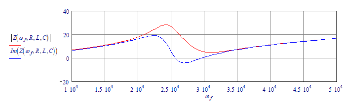

LucMeekes
(To:ssato)
That is because resistors reduce the 'quality', or sharpness of a filter. With that they move the position of the extrema of the magnitude of the impedance.
A given filter with resistors at 10 mOhm:
The maximum of the magnitude of the impedance appears to coincide with the imaginary part being zero, at 25k. Now if I increase the resistors to 1 Ohm:
Notice that the single peak is split into two extrema; resistors are sometimes used for 'pole splitting'. The extrema of the magnitude of the impedance are below 25k and above 30k, while the zero's of the imaginary part are both between 25k and 30k.
If you plot the argument of the impedance along, you will find that its zero's coincide with those of the imaginary part. Argument=0 means there is no imaginary part, that is Im(Z)=0 as well. But the magnitude of the impedance is a mixture of the real and imaginary parts of the impedance. For some frequencies that may give a larger value than the real part alone.

According your confusion about resonance frequency - you have to distinguish between two of them (I am not sure about the correct English names) !
1) phase resonance: this is usually meant when you read resonance and means that the imaginary part has to be zero
2) amplitude resonance (magnitude resonance ?): This is where the magnitude has local extreme.
Phase and amplitude resonance frequency must not be the same and this is what you experience in your sheet.
