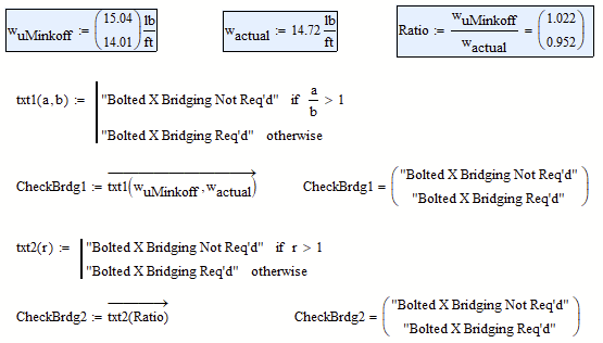

how do i get the "CheckBrdg" yield the answer in a matrix format? please see attached sheet!

How about defining an auxiliary function and call it vectorized.
Either a function with nominator and denominator as argument or one with the ratio as argument.
And of course you should make use of Mathcads ability to work with units.
