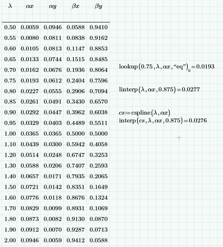

Hi everyone, I have the following table as seen bellow in the attachment and my problem is that I have to extract alphax, alphay, betax and betay based on the value of lambda. Is there any way mathcad can do this on it's own?

A little OCR on your table produces an Excel file data that can be cut and pasted into a Prime input table
Have shown the options to read the table from last four columns based on first column.
Capture.JPG.

You may either use the "lookup" function -> Lookup Functions
or you even may use linear or spline Interpolation to also return values for in-between. lambda-values.
--> Linear Interpolation
--> Spline Interpolation
For further help you would have to attach your Mathcad or Prime worksheet (in case of Prime you also should state which version to use).
Capture.JPG.
