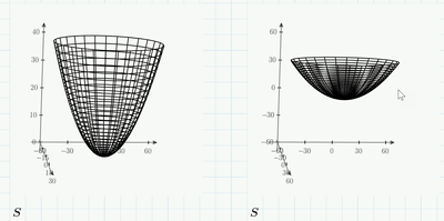

I don't know what the meaning of your "ew 11.mcdx" should be, but you should be aware that in your "tast ex1.mcdx" it is not a surface of revolution which is seen here! Its an elliptic paraboloid. It just looks like a surface of rotation because Prime automatically scales the axis that way and there is no option in Prime to automatically see the object as it really is (equal scale). You would have to manually edit the values for each of the three axis to get the correct view.
See in the pic the comparison - Primes autoscale on the left, manually created equal scale view on the right.
The top view clearly shows that its not a surface created by rotation.
I guess that you just typed in an example you found elsewhere. I can't see any attempt to apply a rotation as e.g. seen in the wikipedia link I posted in my last answer.
