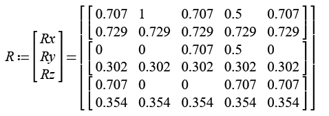

Hi Everyone,
From the following :
How to Rotate a quadrilateral and Plot its image on the Graph ?
Thanks in advance.

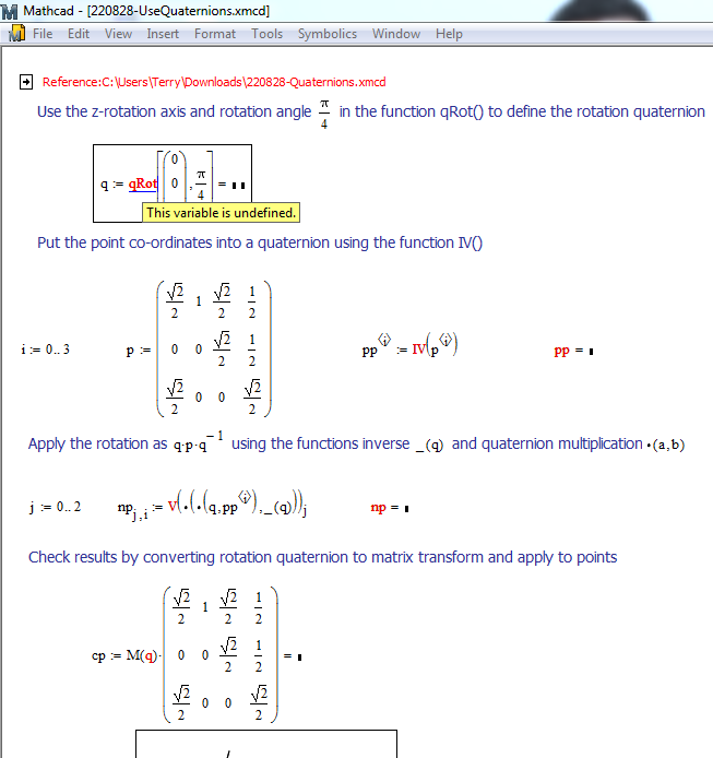

I greately appreciate your time and help with your *.xmcd attacted. I don't the reason for as the following:
"This variable is undefined" was shown.
Thanks again.
Loi.
File location for the referenced sheet at the top of the page must be adjusted to suit your system where the file is located.
Right click on the little arrow and you get this pop up menu and select properties
This pops up a tabbed dialog box go to Reference Tab
Here you can browse button to the location of the file "220828-Quaternions.xmcd" on your system and OK.

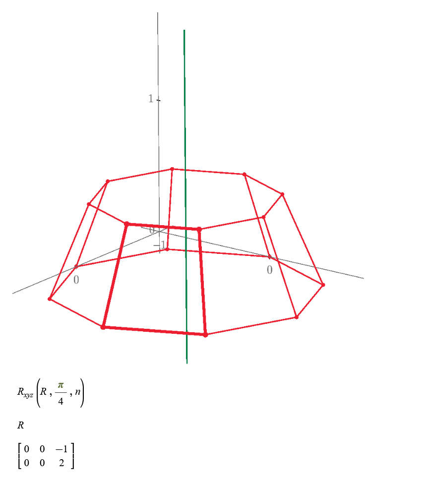

Tokoro, the reason I need help with the screen-shot of program function is : all of us don't have to re-calculate the coordinate of the points for related query :
How to fill color the Octagon ? (make the "lid" for Pyramid) (see the Graph)
Thanks in advance.

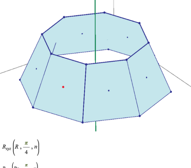

Many thanks for your time and help again, Werner. I guess my question is not clear. I mean my question would be : "How to Fill Surface to Octagon so to fill different color say red color different from blue color":

In other words: "How to Fill Surface that Octagon ?"
(To:lvl107)
Here is one way to do it
MC15 sheet attached

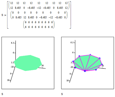

(To:lvl107)
: Is there a way to Fill Surface A Non-Regular-Octagon ?
Its easy if the polygon is convex. Simply chose any point inside the polygon (you may use the center of any chord for instance) and use it the same way like I used the center of the polygon (0/0/height) in my example above when I created the structure Okta[0. Basically using the tringles formed by two adjacent polygon vertices and the center point as a 2x2 patch for the structure Mathacds 3D plot expects (doubling the center point).
Of course it is your responsibility to make sure that all polygon vertices are in the same plane!
If you look at the structure
you see the the three matrices consists of the x-, y- and z-coordinates of the points which form the surface grid.
The second row in each of the three matrices are the coordinates of the polgon vertices (the last one is repeated at the end to close the polygon) and the first row consists of the coordinate(s) of the center point - in the example shown its (0/0/6).
The next picture shows the same structure but a different point inside the polygon ->  (4/-2/6). As long as you don't draw lines and points you won't notice the difference:
You may even use one of the vertices of the polygon as "inside" point, here (12/0/6)
If you do so, you may also delete the first and last column in each of the three matrices.
Bu if the polygon is not convex you are out of luck with this simple method as this may take quite some additional efforts (probably not worth the time), I suspect.
