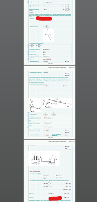

it. I need to run it by putting in a variable from the spreadsheet where the top red mark is, add it to a vector and process it to get a number at the bottom.
So while I can use read excel to get one variable through to get 1 answer, I need it to return to the top, get the next variable and run that one through as well, obviously continuing till I run out of data.

I'll try and post it here. The website through a hissy fit the last time I try to post it.. I'm having to modify it slightly. But to give you something that would work, if you look at the output from the test rig, I want to import the angle into the alpha check variable and the two static ram forces (the last two columns shown) into FLA and FLB respectively. For where I'm currently at in the worksheet, if it could export the magnitude of R4A and R4B so I can see how it works if it's possible (or some basic steps on how to go about it, I imagine if I can get this to work, we would use something similar quite often)
I did add some extra lines. If I could automate the read and write excel loops, I think that would work

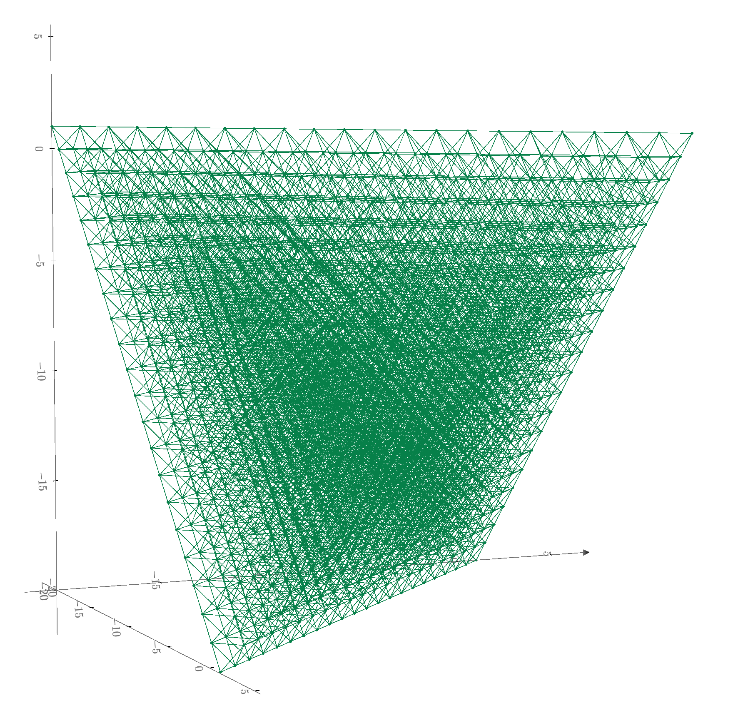

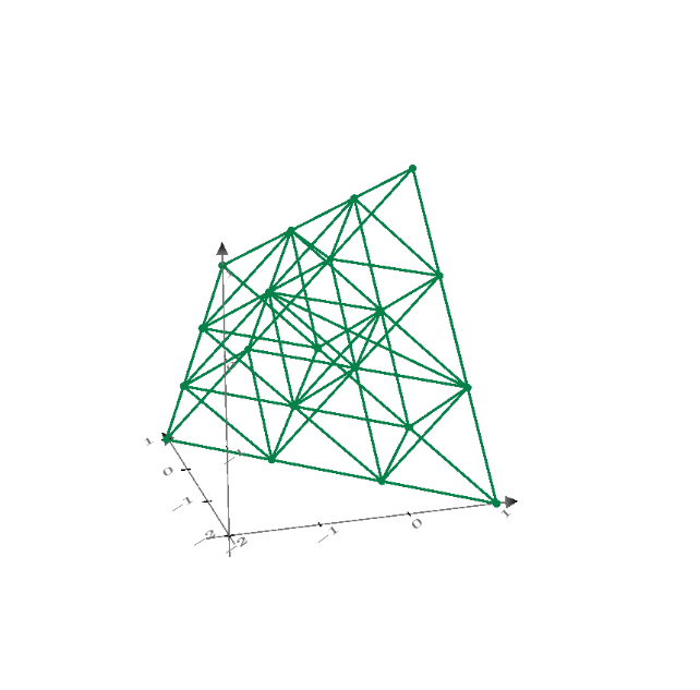

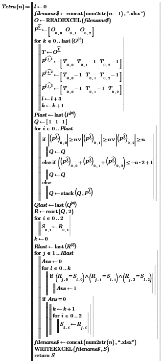

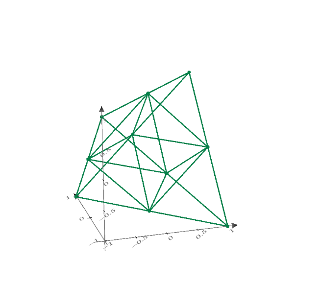

Using READEXCEL and WRITEEXCEL I made tetrahedron plots. At first READEXCEL read original tetrahedron 1.xlsx. Then made and write 2.xlsx file. Thereafter program continue the sequence.
You must make unique names for each excel file and read and write it sequencially.
