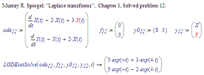

Now on to, task 2:
I have one implementation in Mathcad 11 that allows:
And on the other LODE it returns:
So I guess it's done.
Well, almost... I'd like to make sure that the coefficients of the derivatives don't contain the independent variable. Because if they do, you get the wrong answer. Prof. Birkeland's polynome does not account for that, and I'm certain it's not easy to implement support for it..
Example:
this is not the solution.
In the attached file is a routine GetODEparts, with some examples next to it.
Please check if it runs in Mathcad 15. These are the expected results:

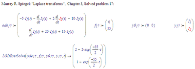

(To:LucMeekes)
Unfortunately ODE systems don't work. The error message is an less helpful "pattern match exception".
LucMeekes
(To:Werner_E)
Hmm, now it becomes tapping in the dark.
Please try the attached.
(To:LucMeekes)
Sorry! Same error again.
LucMeekes
(To:Werner_E)
Installed a trial of Mathcad 15 and found out that, where this is posible in Mathcad 11:
Mathcad 15 is more restrictive:
LucMeekes_2-1602694787367.pngLucMeekes_3-1602694816566.pngLucMeekes_4-1602694851303.png
The issues are resolved now, and the result is posted in https://community.ptc.com/t5/forums/replypage/board-id/PTCMathcad/message-id/192090.
