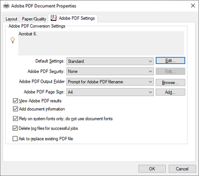

I finally found where the problem lies: it is made up of several lines of text with formulas inserted. What is the source of the non-production of the pdf file? I attach the file (it is a part of an appendix):

On closer inspection of the sheet, my hunch is that the problem lies with the backwards E symbol that precedes "M such that". But that's just a hunch, based on the fact that it is the one character that doesn't look the same in the .xmcd file as compared to your screenshot. On the other side the sheet is small enough that you could try what happens if you take that symbol out and print to pdf...
I'm also assuming that you are using the Adobe PDF printer, because looking at that driver I find:
This is the interface. Now select 'Properties', to get:
(I wonder what effect (un-)ticking "Rely on system fonts..." may have for your case.)
And if you click on Edit (next to Default settings), you get:
There's the font SegoeUISymbol. It is not listed in either of the embed options.
Here I wonder what would happen if you set SegoeUISymbol to be either Always, or Never embedded.

Where is another pdf printer located? In which folder should the "Adobe pdf settings" file be saved? I used the same one of the "special" file, however on a new print attempt, the default settings appear and not the modified ones.
(To:-MFra-)
The settings you change when printing a document are not permanent.
To change the default settings permanently you have to use the "Printer & Scanner" menu.
One way to access it is to left click the "Start"-Window at the lower left and start typing "Printer ..." until you see an option like "Printer & Scanner, system settings" (in Italian) turning up. Click it, chose your printer ("Adobe PDF") and use its  property settings to set the desired default values.
(To:-MFra-)
As already suggested in the other other thread, I guess you should uncheck "Rely on system fonts only" in the properties menu as already suggested by Luc. It worked for me and I could print your file. But on the other hand I never had problems by just using the print preview as you wrote - I only saw a similar error message like the one you mentioned when I tried to actually print (create a pdf) the file.
Unchecking this options allowed me to create the pdf with AdobePDF.
I never had any problems when I just used the print preview (you wrote that you experienced the error already there) but got the same error message you showed when actually trying to print(create the pdf) the file.

-MFra-
(To:Werner_E)
the pdf is correct. A thousand thanks.
