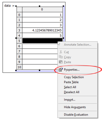

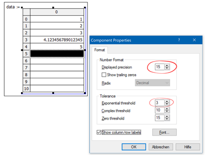

To format the number of decimals shown in a Mathcad table, you right click the table,
select "Properties" and now you can format how the numbers should be displayed

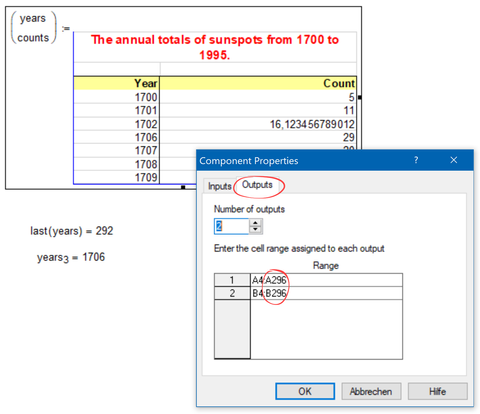

Deleting rows in Excel does not change the number of rows which are transferred to Mathcad. You set the range to be transferred by right clicking the table in Mathcad, select "Properties" and in the "Outputs" tab you can change the range to be transferred to Mathcad. For the picture I deleted three rows (1703-1705) in Excel and so I changed the number of the last row to be used from 299 to 296. Now the number of rows of the Mathcad vector changes accordingly.
