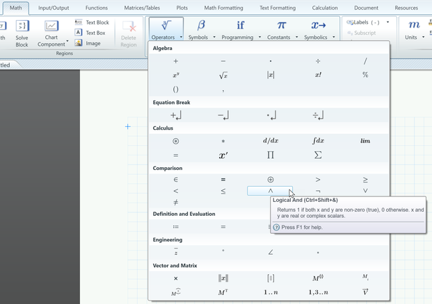

I want to simulate a program such that two conditions must meet at the same time to run the program. I saw Mathcad does not have a "and" statement. Please help me out with this. I have attached my file. My version is prime 4.0.

Mathcad (and even Prime) definitely HAS an "and" statement!

I don't see it in my Prime 4.0. I even tried in resources but it was not there
In the meantime I attached a picture to my post above which should make it clear.

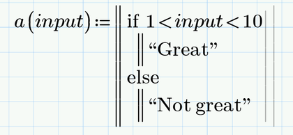

BTW, for the example you posted you don't need any "And":

Thank you very much. It worked
