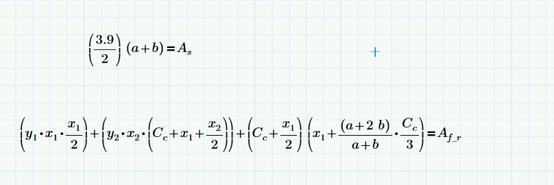

Sir i have two equations "a" and "b" are the two variables how to find the values of and b from thease equn

You could setup a solve block to solve the two equations. However, it seems you have an error in your formulas, see below.
Mike
LucMeekes
(To:ms-4)
Put the two equations in an array and choose 'solve' from the symbolics menu and supply a,b as the variables to solve for.\
I replaced the (assumed)  knowns in your equations with other constants and solved.
If you don't have a symbolics menu in Prime, you're using the Express version.
You should be able to take it from my solution.

yes sir iam using prime sir dont have that option. . .
LucMeekes
(To:ms-4)
But you should be able to use my solution.
Note that my A is your first two equation parts between brackets summed.
My B is your Cc+x1/2
My C is your x1
etc.

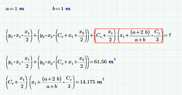

But his units are inconsistent. Shouldn't a and b have the same units?

It is the first half of the equation which is the issue.
A.f_r has the units m^2. The second of the equation has the unit m^2.
Mike
Yes, they should, because they're added.
But for my, more general, solution that shouldn't make a difference.
Just plug in the right substitutions, and bingo.
