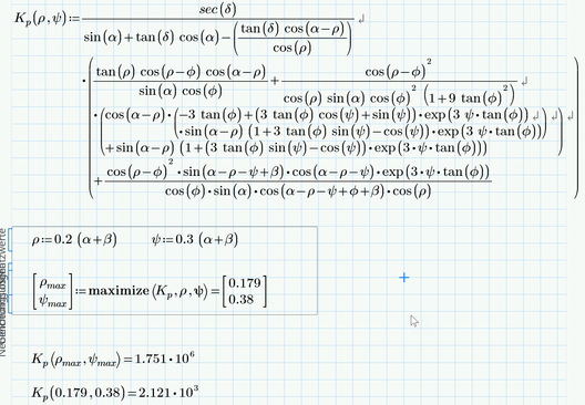

Based on the published solution, the maximum value of the function for the given inputs should be in the range of 2.56 - 15.73
And you got a value of approx. 2000. That means that "maximize" did a good job, doesn't it?
Which version of Prime the file was created in? After recalculation in Prime 9 I get an error message because maximize was used the wrong way. K.p is a constant (6.02) and you used it as a function. Actually  I wonder why this worked in any version of Prime, but obviously it did.
Correct way is to define the function in front of the solve block and use the function there.
As you can see in the pic below we get an even larger result if the values from the solve block are used in their full stored precision:
I have not looked in your sheet in detail and have not checked if you retyped the function definition correctly - maybe it would be worth doing so ...

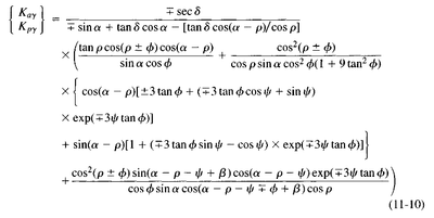

I am also including the section from the text for information.

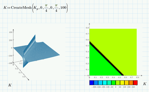

I plotted the function you defined and it looks like K.p can take values from minus infinity to positive infinity. Looks like rho+psi=~32 deg. This means that maximizing does not make much sense.
I limited both angles (rho and psi) to 0 to 45 deg in the plot.
So either there is a much more restrictive limit to the angles ar there is something wrong with the equation (either the one typed in your sheet or already  the one published in the pdf).

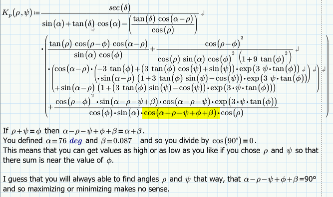

EDIT:
I looked further in your equation and found this:
