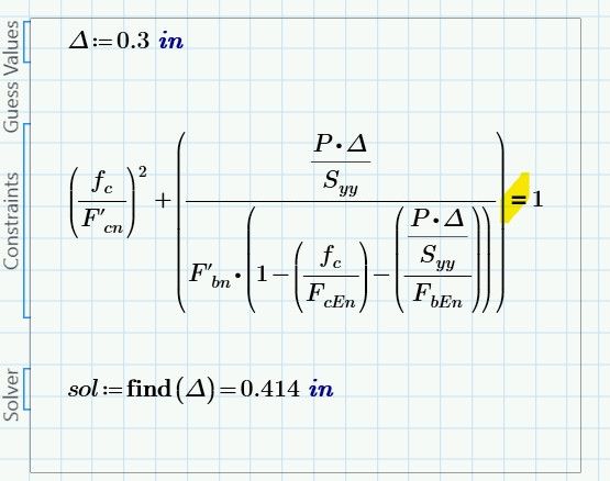

I have created a solve block but the block only returns my guess value as a solution which is wrong.
Using <= in the solve block means many solutions including your guess values,
Use an equality sign "CTRL =" so only one unique solution..
Cheers
Terry
Why do you think its wrong?
0.2 inches definitely IS a possible solution as 0.641 definitely IS smaller than 1.
Cheers
Terry
Thankyou!!!!!!
