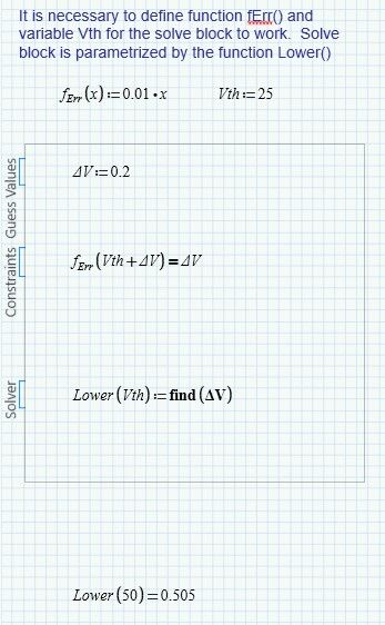

You need to make some definitions before the solve block.
See the comments in the file
No!! it should not be necessary to define f.err or Vth before the solve block because in the sheet provided by the OP both are provided as arguments of the solve block function "Lower".
But in your screenshot it looks like that defining the function argument Vth with an arbitrary value in front of the solve block seems to make it work OK. @Manfred_F  So this may be at least a work around to make the solve blocks work in the buggy version 7 - give it a try!

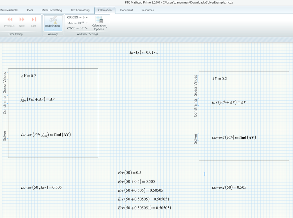

Perhaps someone using Prime 8 could report whether or not the two solve block functions in the OP's unmodified worksheet work OK after a recalculation. Chances are that the bug may have been already fixed in the current version.
If not, I would suggest reporting this bug to PTC support and hoping for the best...

So it looks that either its a bug introduced in P7 and already fixed in P8 or that there is something faulty with the installation of @Manfred_F's P7.

I opened the file with Prime 7, and saw no results.The Stop All Calculation and Calculate buttons were greyed out.
Then I pressed the Auto Calculation button and promptly got:
As well as the result for Lower2(50)=0.505.
Can't show here because the forum software is not helping by refusing to show pictures.
Anyway, is this what you hoped to get?
(To:LucMeekes)
So this means that maybe the problem simply was that "Autocalc" was turned off !? 🙂
