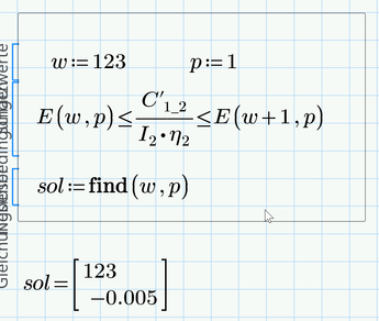

Unsure if solveblock will work Please help
(To:IS_10705139)
You may do it that way

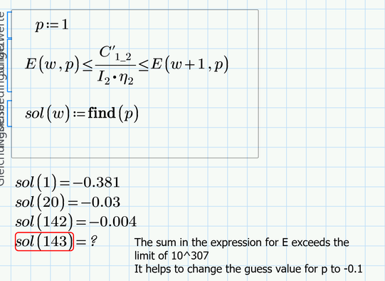

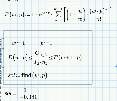

But whatever guess value you chose for w, it will be returned unchanged, only the (negative) value for p changes
So you could as well use the solve block to just find p dependent on w:
p as a function of w:
