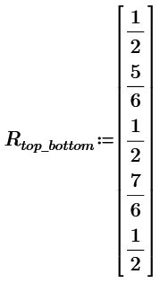

Solve diagonal resistance of resistor 3D mesh.

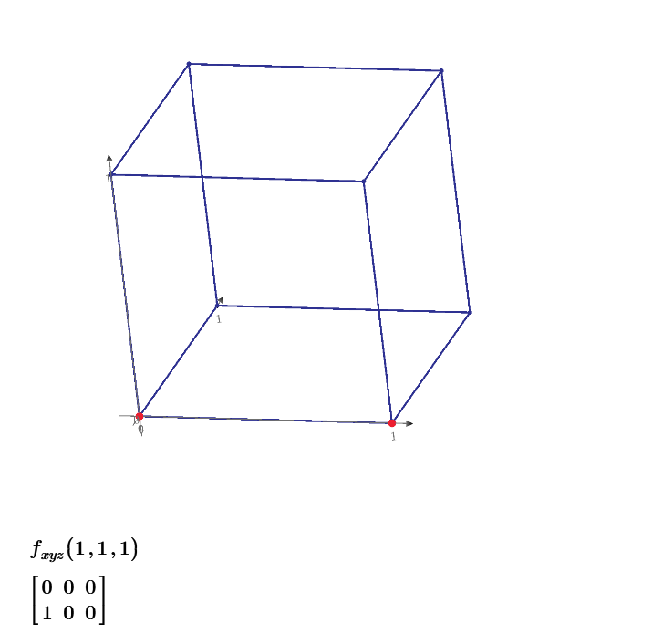

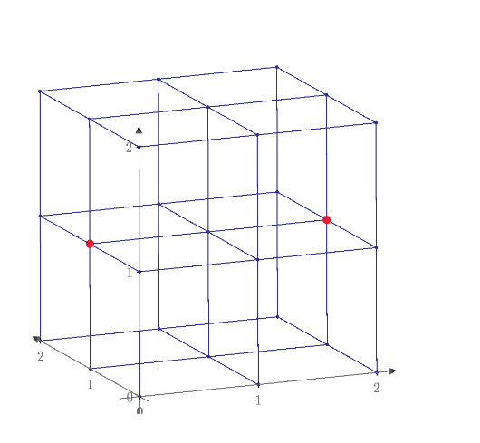

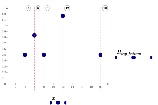

Diagonal resistance of regular polyhedron. R(4)=1/2, R(6)=5/6. How about R(8), R(12) and R(20)?

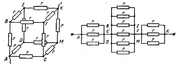

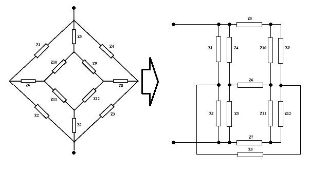

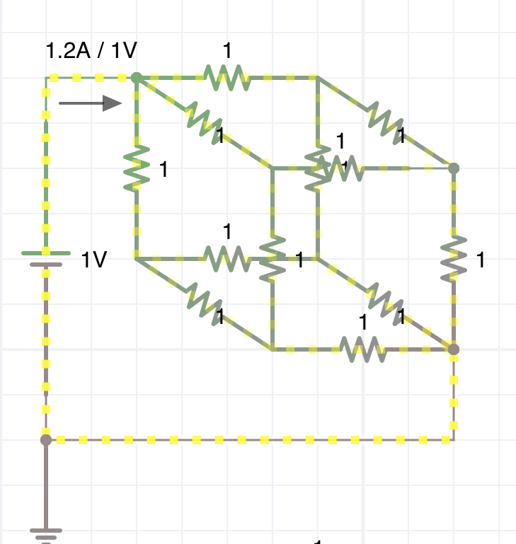

A simplification of the network topology allows you to easily apply Thevenin's theorem:

LucMeekes
(To:-MFra-)
Note that this is a different network than the original network of Ttokoro.
If the entrance is at the top (as shown) then the exit should be at the crossing of Z7, Z11 and Z12, not on the crossing of Z2, Z3 and Z7!
-MFra-
(To:LucMeekes)
In fact, I referred to the network (1) in the photo, instead I should have analyze the (2):

image.pngThe diagonal resistance of resistor 3D mesh is 5/6 ohm.

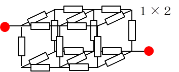

How about 1*2 3D Mesh?
Each branch resister is 1 ohm.

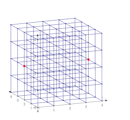

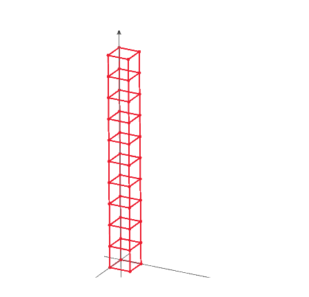

i=2:    1*1*1
i=3:    1*1*2
i=4:    1*1*3....

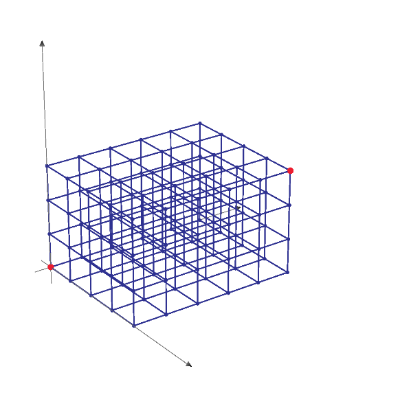

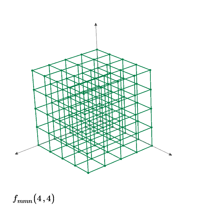

Diagonal resistance of resistor 3D mesh.4*4*4=

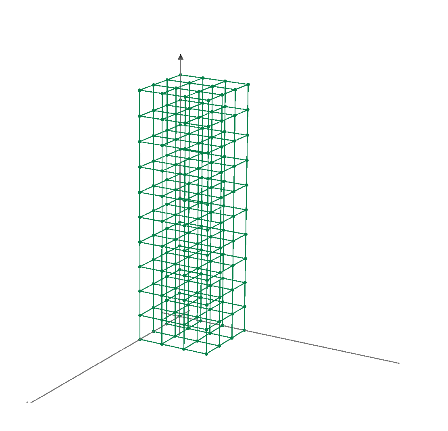

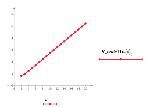

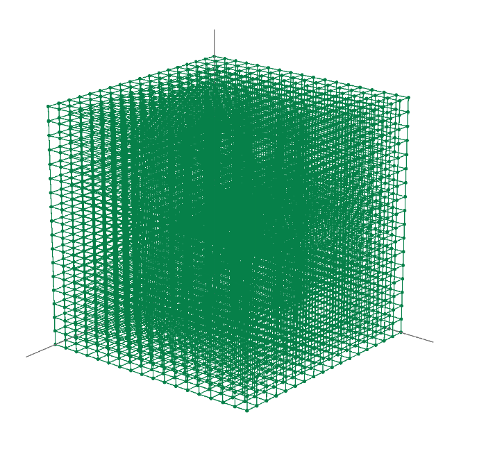

image.pngimage.png Diagonal resistance of resistor 3D mesh 20x20x20.

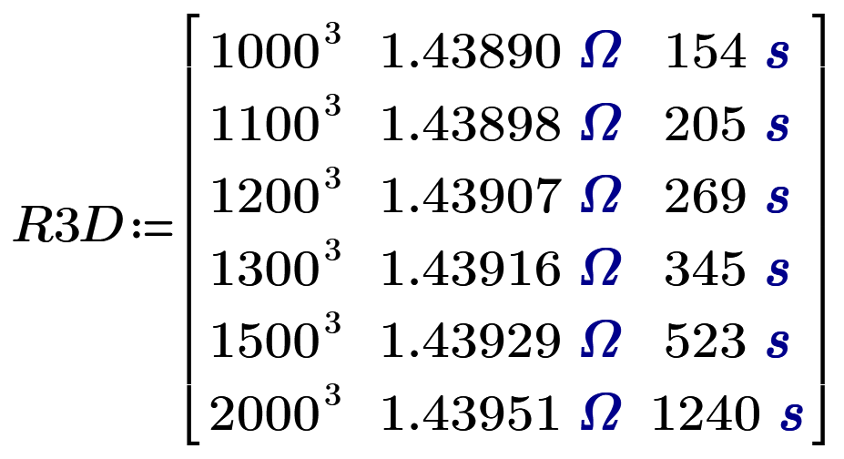

R3D(1000*1000*1000)=1.43886 ohm.

Diagonal resistance of resistor 3D mesh 1000x1000x1000. 1 h to solve the 1000^3 3D mesh.
ttokoro
(To:ttokoro)
Now Prime 6 can solve all 3D resistor mesh problems for both finite and infinity connections.

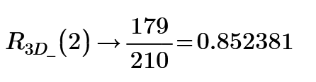

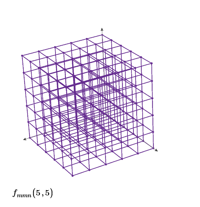

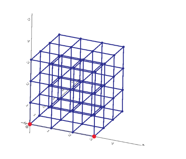

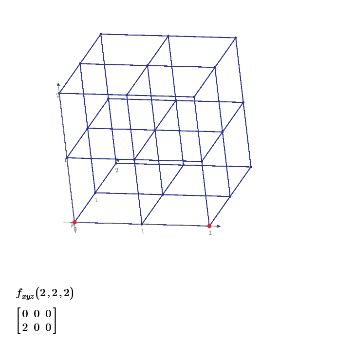

n=1 The resistance of resistor 3D mesh of (0,0,0) to (1,0,0) is 7/12 ohm.
n=2 Do you know the resistance of resistor 3D mesh of (0,0,0) to (2,0,0) ?
ttokoro
(To:ttokoro)

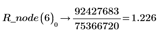

The answer of 2*2*2 (0,0,0)-(2,0,0) is 179/210. What is 3*3*3 (0,0,0)-(3,0,0)?
ttokoro
(To:ttokoro)
The answer is
image.png.

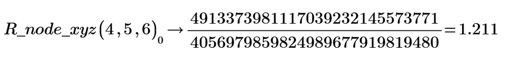

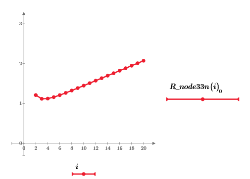

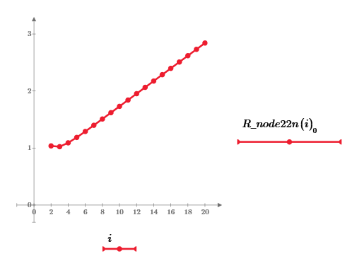

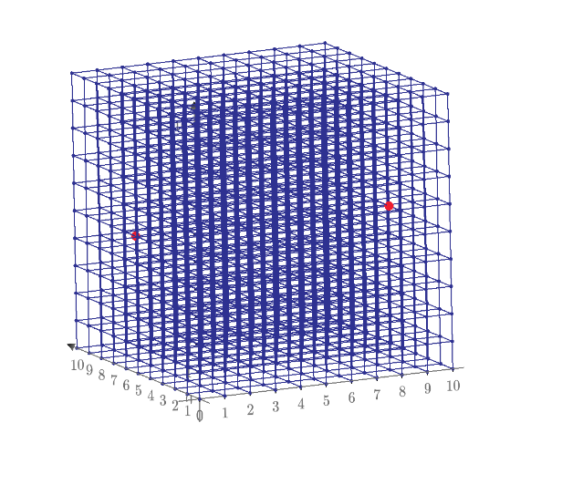

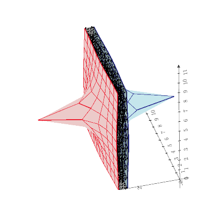

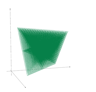

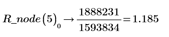

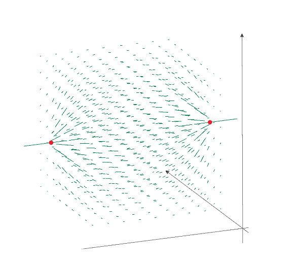

Face center to center resistance of 11*11*11 mesh.
image.pngimage.pngThe answer.
 image.png The node potentials 3D view.image.png The 3D field view.
