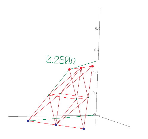

Solve diagonal resistance of resistor 3D mesh.
Diagonal resistance of regular polyhedron. R(4)=1/2, R(6)=5/6. How about R(8), R(12) and R(20)?

Resistor mesh of 60 nodes is made by Maple 2021. Resistance of node 1 to 31 is 17/11 ohm. The one of node 1 to 2 is 0.649 ohm. Not sure this is true but Mathcad can solve them.

This is not solving 3D 1*1*1 grid resistor mesh only. Using Mathcad or other mathematical programs we can calculate more interesting resistor grid problems.
1/3+1/6+1/3 can not use if the grid is 1*1*2. I post many unique resistor grid problems here.  This time 60 node soccer ball resistor grid result is shown. Please try to solve it because I can not find any answer in WWW sites. Without using Math software, we can not solve such as R1-2 of resistor ball.
1*1*2                                                                                        1*1*1

In puzzle 28 of my post, the most far surface distance position from [0,0,0] of 1*1*2 cuboid is [3/4,3/4,2].
So, I make 4 nodes every unit distance and connect each node by 1 ohm to make electric circuit. Only surface of cuboid is meshed by resistors.
Then measure the resistance from node [0,0,0] to all nodes. Mathcad shows the result as below plot.
Plot says that the largest resistance node is node 161, it is [1*1*2] position and 1.537 ohm.
The resistance between [0,0,0] to [3/4,3/4,2] is node 155 is 1.41 ohm.
The almost most far points of 1*1*2 cuboid are [1/4,1/4,0] to [3/4,3/4,2]. These are node 6 to node 155 of my electric circuit.
And the resistance between these nodes is 1.286 ohm. These results are very interesting.

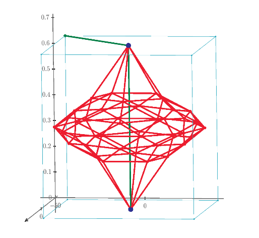

G matrix can plot 3D by maple 2022 graph theory package. And make potential 3D plot by Mathcad Prime.
Z value shows the resistance of node to node.

Now, we can show all potential of each node of C60.

The resistance and voltage distribution of V2 to V6 domes.

Multi nodes to multi nodes resistance of one ohm mesh circuit. All nodes positions and potencials are plotted.
