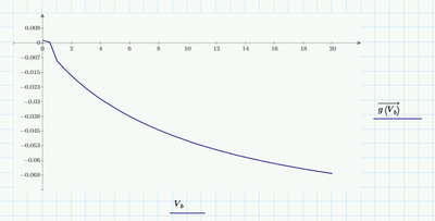

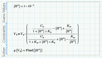

I have a solver block with an equation and a function
Further down the worksheet I define two ranges of values, x and Vb. Both ranges have values in the range 0-20.  g(x) returns values but g(Vb) shows as
I am attaching the worksheet and an Excel workbook which contains the expected results.

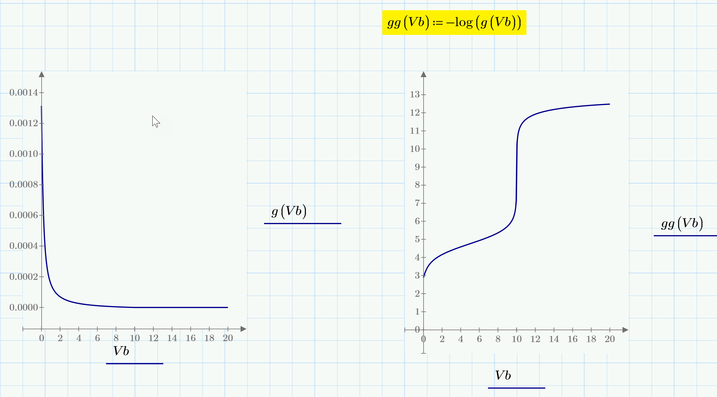

When you wrote "Of your two suggestions, I prefer the second" I thought you were talking about my suggestion of defining a new function gg(Vb):=-log(g(Vb)) below the solve block which defines function g. A function which calls the solve block function g and using NO vectorization. All these functions are setup to deal with single scalar variables and are just later called vectorized with a vector of argument values. It can be seen in the picture I added to that post.

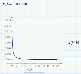

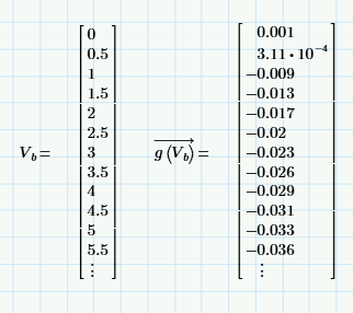

By evaluating the ranges you defined for the part of Vb, you've changed the ranges into vectors,
Seems that Prime wants you to vectorise the call to g(Vb):
Look up vectorise (in the bottom right corner of the operators, tableau) and see your result.
Then this could be the plot:

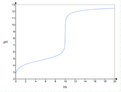

Thank you, Luc. I'm not sure why the vectorisation is necessary but obviously it is.  Anyway, I then used
I had to experiment with different guess values in order to get the correct results over the whole range of Vb but 1E-10 seems to work well and I can get a plot like this

You would have to provide an equation in ph rather than in [H+] for the solve plot to solve.
You may replace every occurrence of [H+] in solve block for 10^(-[H+]).
EDIT: Of course it should read 10^(-pH) and the resulting equation should be solved for pH. Actually it would also work OK if you use 10^(-[H+]) as I had written (mistakenly) because the name of the variable does not matter but of course this would be quite confusing and should not be done.
Or you leave it as it is and define an additional function which gives you pH for provided Vb

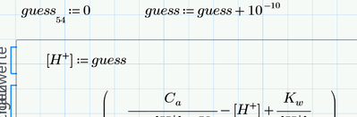

Thank you.  My initially posted worksheet did indeed give many negative results and that was because of a poorly chosen Guess value.  The attached worksheet is correct in so far as it gives the results I expected.

I noticed that you wrote about the guess 10^-10 and we get positive values that way and therefore edited my post and added the new screenshot.
I, too, would got for option #2 and simply define a new function for pH which in turn calls the solve block function g.
On word (or some more) of explanation because you wrote that you don't understand why you have to use vectorization.
If you use a vector Vb, then the equation in the solve block has a vector on its left hand side and a scalar value (H+ guess is a simple scalar) on the right hand side. Whatever value Prime would chose for H+, the right hand side never will turn into a vector and so Prime can't find a solution.  But if you vectorize the function call, Prime will feed the elements of the vector one by one into the called function and collect the result in vector.
You could (but shouldn't) provide a guess vector H+ and in case of your equation this would even work OK. But it sure is nor a good idea because your function now only works OK if the argument is a vector with exactly 55 elements.
And if your equation contains an expression like H+*H+, it would be interpreted as a vector  product and what you may have intended.
So forget this idea and use vectorization, if the function argument is a vector.
