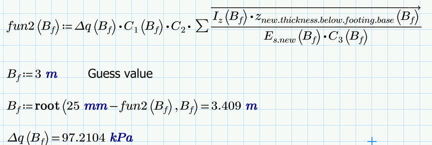

I am trying to solve an equation that has condition statements and find the roots.
Please help,
(To:fahmed-2)

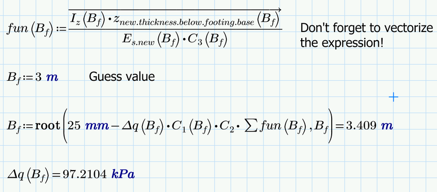

So you should solve the equation for q0 and not for B.f. You can make the solution a function of B_f as explained in my previous answer.
You may use either a solve block or the root function - its up to you.
You can speedup the calculation significantly (factor 5) by using the approach which I already showed in a previous posting
10 REPLIES 10
(To:fahmed-2)

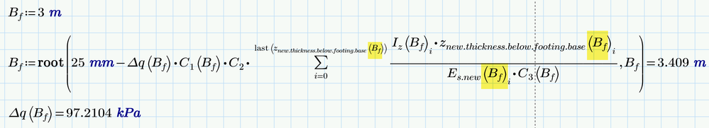

  • The symbolics can't do well with conditional expressions, so you should rather use Primes numeric methods (either a solve block with "find" or the "root" command.
  • I guess you rather want to solve for B.f and not for the function Deltaq(B.f)
  • Again you used function names as if it were simple variables! If you use a function, you have to provide the function argument!
You could also do it that way:
or maybe even that way

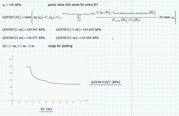

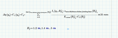

My ultimate goal is, based on the following equation, I would like to find the values of qo  for different values of B_f and plot the curve. Please help
fahmed-2
(To:fahmed-2)
Thank you @Werner_E . My original intent is ,based on the following equation, I would like to find the values of qo  for different values of B_f and plot the curve. Please help

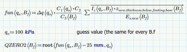

(To:fahmed-2)
Get Bf as a vector by using equal at end of definition trick
Create what is called a parametric Solve Block with a function and parameters. Function is bearing, parameter is Bf.
Use the function with element by element of vector Bf to get a vector answer ans
then plot the values required.
