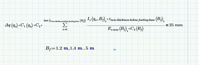

I am trying to solve an equation that has condition statements and find the roots.

So you should solve the equation for q0 and not for B.f. You can make the solution a function of B_f as explained in my previous answer.
You may use either a solve block or the root function - its up to you.

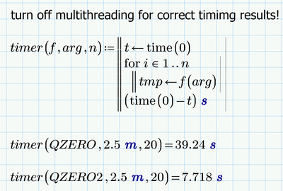

You can speedup the calculation significantly (factor 5) by using the approach which I already showed in a previous posting

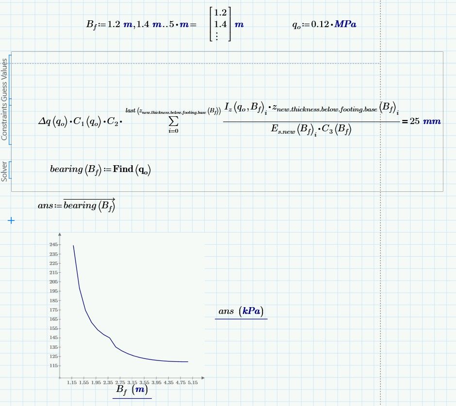

Get Bf as a vector by using equal at end of definition trick
Create what is called a parametric Solve Block with a function and parameters. Function is bearing, parameter is Bf.
Use the function with element by element of vector Bf to get a vector answer ans
then plot the values required.
