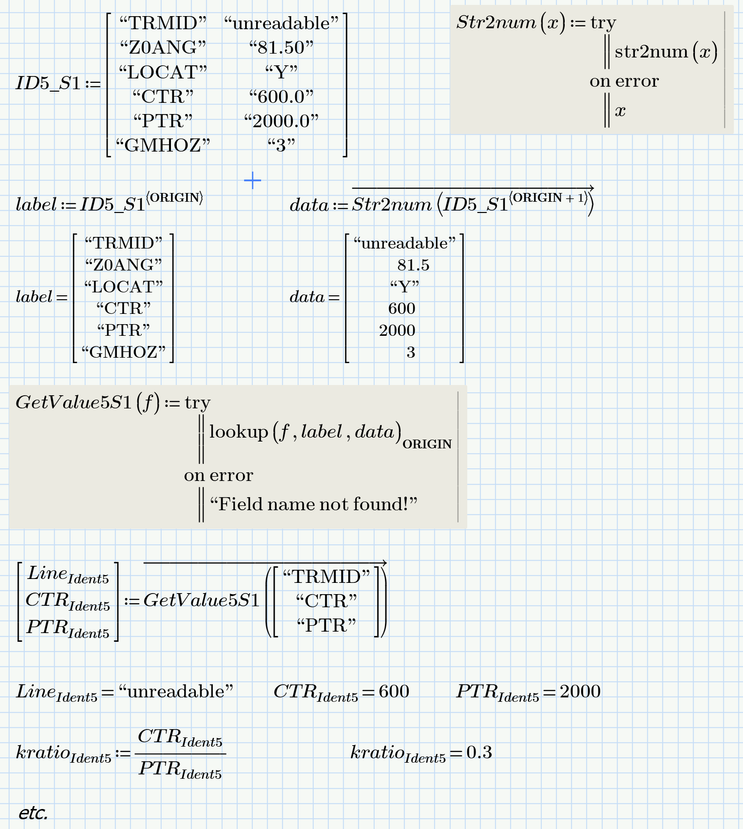

I have a set of commands that sort through a text file to get values, make some of those values a number and then name those values.  (See Attached).  When I calculate the sheet, I can literally see Prime paint the values into my sheet.  Is there a faster way?
(To:Snowshoeman)
But the includes would only be done once. After that extracting the values via the GetValue5S1 function should be quite fast without you literally seeing how Prime paints the values.
It might speed up (but only a very little bit) if you do the conversion from string to numbers only once for all the data and not in the GetValue function.
I don't think that I can say any more about your experiencing such a slow performance without actually seeing the sheet(s).

Whats the dimensions of matrix ID5_S1, how many rows?
Shouldn't be so slow normally.
It is 270 rows long.  It might be slow because the file does an INCLUDE statement 4 times before it does the text file processing.
(To:Snowshoeman)
These are great suggestions!  Thanks!

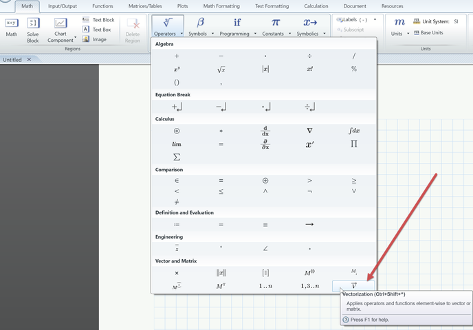

As near as I can tell,, the arrows are symbolic operation operators.  Why are they required in the above?
(To:Snowshoeman)
No, these arrows don't indicate a symbolic operation but rather 'vectorization'.
See: Vectorize Operator
Now that I know what it is and watched a video, I understand.  Thanks!
